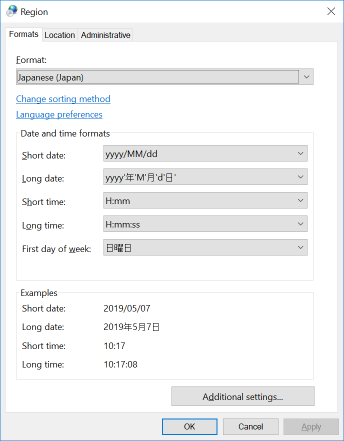

Post by Tero » Tue May 07, 2019 7:46 am
Change Windows' Date & time, number and currency settings to "Japanese (Japan)":
Format settings.png (31.72 KiB) Viewed 44452 times
Create a program which uses GDIPlus (uses startup and shutdown). Create two charts with GDIPlus rendering disabled. When trying to disable GDIPlus rendering for the second chart a call to GDIPlusShutdown throws an exception.
