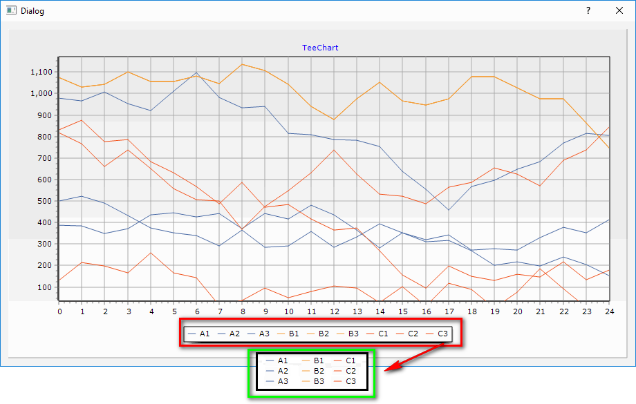

We need to display the legend of specific series in user-defined position (a group of series' in different columns). Is there a way we can do this??
We tried the approach to use custom position setting in legend options, but the symbols did not move along with the legend text.
Attached image shows exactly how we need the display of series titles in legend.

I've added a ticket in the public tracker to implement Legend's NumCols, NumRows and MaxNumRows properties from TeeChart VCL (note Teechart ActiveX is a wrapper from TeeChart VCL):
http://bugs.teechart.net/show_bug.cgi?id=2180
When this will be done, you should be able to do something like this.
