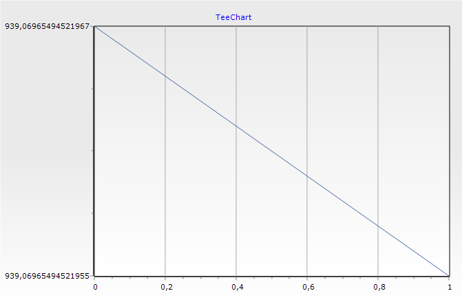

Re: TCHART not responding with high precision double values
Post by Yeray » Wed Nov 07, 2018 10:35 am
I could reproduce it in ActiveX using VB6, and also in TeeChart VCL.
I think the issue is soon or later you'll have to find a compromise.
Here it is a trick you can do if you are not going to have values far from that ~939. The idea is to substract the integer part to represent the data without errors. Then, use OnGetAxisLabel event to format the labels adding the integer part back in:
Private Sub Form_Load()
  TChart1.Aspect.View3D = False
  TChart1.AddSeries scLine
  Dim Y0, Y1 As Double
  Y0 = 939.06965494521967
  Y1 = 939.06965494521955
  TChart1.Series(0).AddXY 0, Y0 - 939, "", clTeeColor
  TChart1.Series(0).AddXY 1, Y1 - 939, "", clTeeColor
  TChart1.Axis.Left.Labels.ValueFormat = ".##############"
  TChart1.Axis.Left.Labels.Style = talPointValue
  TChart1.Axis.Bottom.Increment = 0.2
Private Sub TChart1_OnGetAxisLabel(ByVal Axis As Long, ByVal SeriesIndex As Long, ByVal ValueIndex As Long, LabelText As String)
  If Axis = 0 Then
    If (SeriesIndex > -1) And (ValueIndex > -1) Then
      LabelText = "939" + Format$(TChart1.Series(SeriesIndex).YValues.Value(ValueIndex), TChart1.Axis.Left.Labels.ValueFormat)
    End If
  End If
