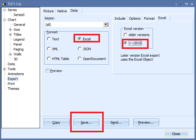

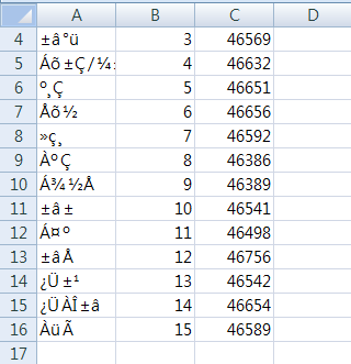

Korean is broken as shown below.
Test result "> 2010" option does not break Korean.
Edting Option.png (19.25 KiB) Viewed 24901 times
So I want to use the "> 2010" option but I can not find the TeeChart2018.ocx function.
Please tell me how I can use the "> 2010" option using VC2013.
Re: Export to Excel have korean issue.
Post by Yeray » Thu Sep 27, 2018 9:33 am
I'm afraid the exportation to .xlsx hasn't been implemented yet in TeeChart ActiveX so it can only be used from the editor, inheriting the feature from TeeChart VCL. This is a feature already in the wish list for the next releases: #1670.
