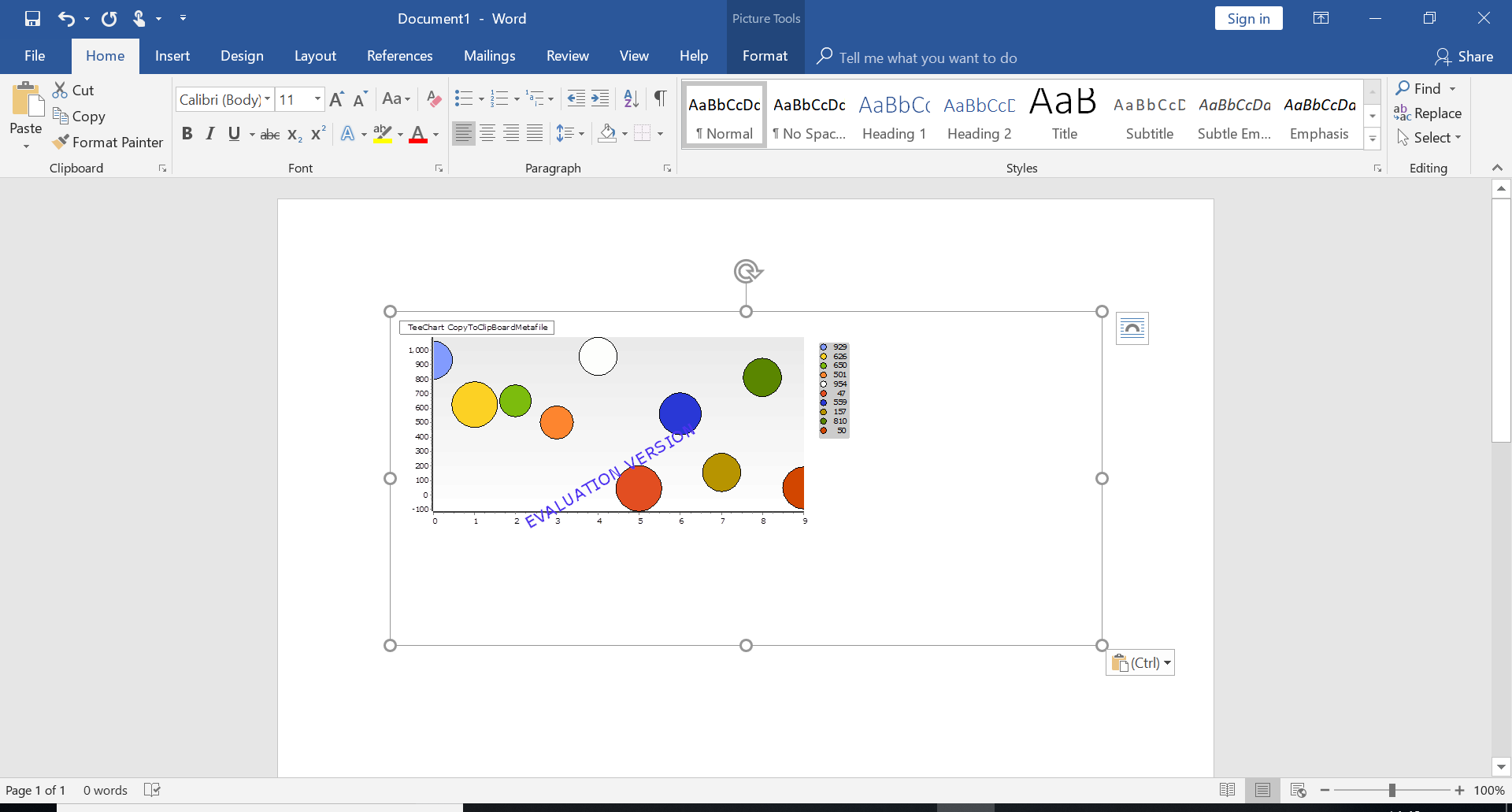

When running on displays that have DPI scaling enabled (i.e. 125% or 150%, etc.) the export of the charts to EMF or WMF format appear smaller than the original, however the overall image size is the correct dimensions so you get a smaller chart appearing in the top left of an image. Is there a way to get this type of export to work correctly on systems that have the system wide zoom factor set to anything other than 100%? This issue happens with Windows 7, 8 and 10.
Exporting to other format such as PNG, BMP or JPG does not have this issue with scaling, however the application this is being used with requires the exported images to have a transparent background. I tried PNG format as this should support alpha transparency however I can't find a way to create an exported image of a chart with a transparent background from TeeChart - is this possible with any other format other than EMF/WMF?
