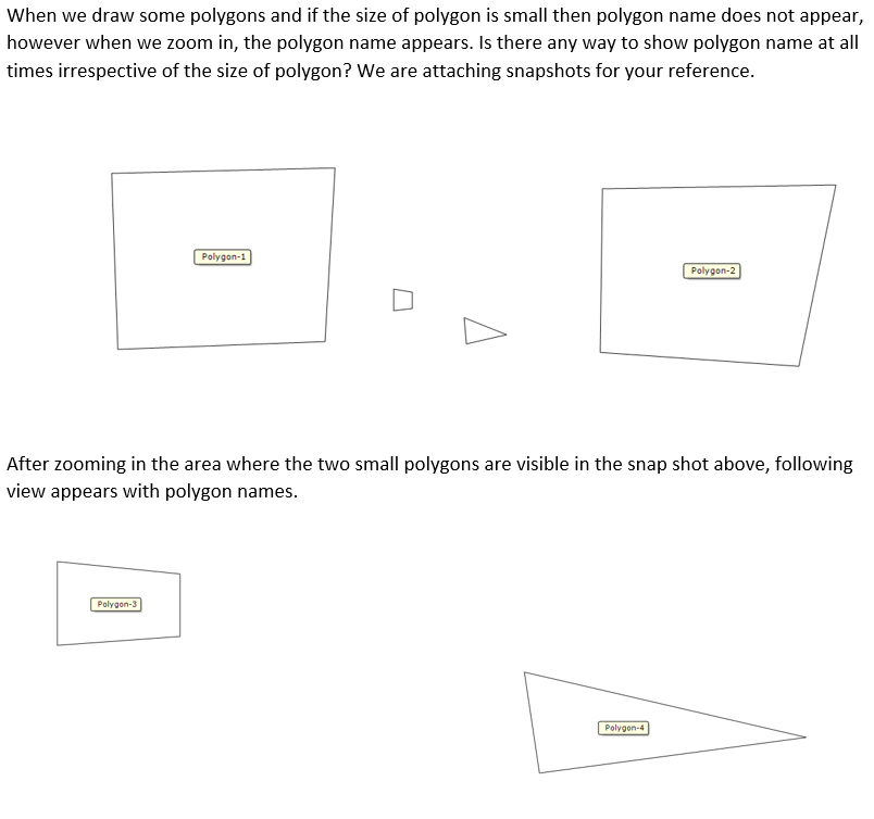

We are facing an issue in polygon name display as shown in snap shot attached. The issue is that when the size of polygon is small then polygon name does not appear, however when we zoom in or the polygon is bigger in size, the polygon name appears.

What series type are you using to draw these polygons?

Thanks for your reply. We are currently using map series for polygon drawing.

By default, the TMapSeries has "MapMarks.AutoSize" property set to "True". This changes the font size trying to fit the text in the shape bounds, with a minimum size of 5.
If you set the "MapMarks.AutoSize" property to "False", the "Marks.Font.Size" will be respected and the marks will be shown if they fit in the shape bounds.
If you want to draw the the marks out of the shape bounds, you can draw the text manually at OnAfterDraw event.
