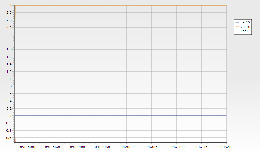

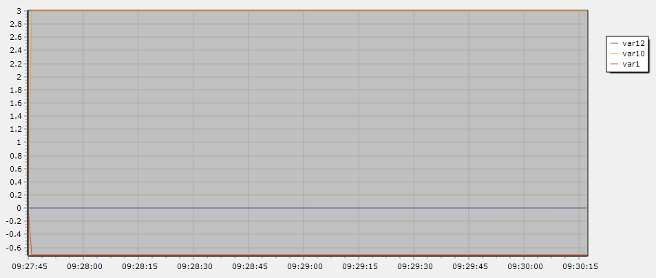

Thanks for your answer. I have another question:
I saved the TChart(looks like attached file : origin.png) as *.tee file,
but when i open the saved file(*.tee file), it becomes this: saved.png, the background is changed.
can you help me to fix it?
Re: tchart import : Wrong *.tee file format
Post by Yeray » Mon Jan 15, 2018 8:54 am
I've reproduced this problem so I've added it tot he public tracker:
http://bugs.teechart.net/show_bug.cgi?id=1966
