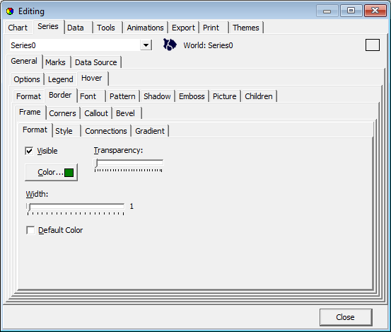

When you mouse over a country in a map chart the country outline is highlighted. On my system this is an orange color. And the outline line thickness is probably 3 or 4 pixels. How can I change the color used for the outline and is it possible to use a thinner line?

You can modify the Series Hover through the editor:
However, I'm afraid you can't do the same by code. I've added it tot he public tracker:

Thanks Yeray. Does not seem to work for me. I change it as per your screenshot but it reverts when I look at the dialog in the screenshot again. WIll not change to the colour I set or the thickness.
