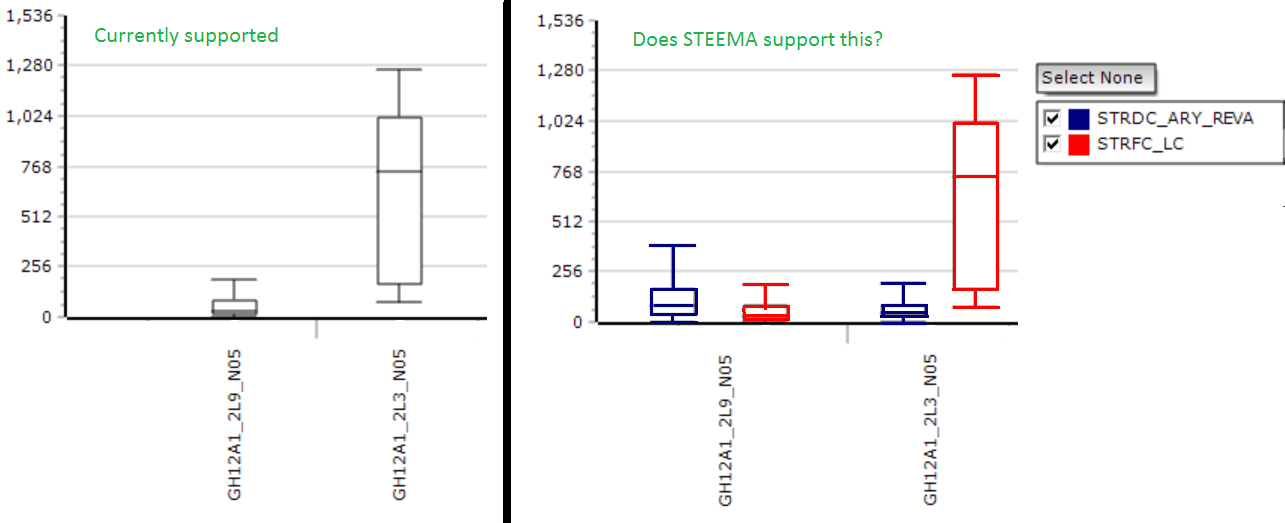

We are currently using the STEEMA control in our window based application to plot boxplot charts. These charts are generally drawn for a certain X axis label, but no legends.
Does STEEMA charting control support multiple itemed legends for boxplot charts?
The supporting example to the above question is attached as PNG file.
Do let us know if STEEMA does support this requirement and if yes, then how to set it up in an MFC application.
If this is not supported, please register this as an URGENT enhancement request and let us know by when this feature would be available.

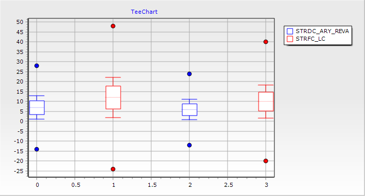

You can do something like this:

TChart1.Aspect.View3D = False
Dim i As Integer
For i = 0 To 3
TChart1.AddSeries scBox
TChart1.Series(i).FillSampleValues
TChart1.Series(i).asBoxPlot.Position = i
If i Mod 2 = 0 Then
TChart1.Series(i).Color = vbBlue
Else
TChart1.Series(i).Color = vbRed
End If
If i > 1 Then
TChart1.Series(i).ShowInLegend = False
End If
TChart1.Series(i).asBoxPlot.Pointer.Pen.Color = TChart1.Series(i).Color
TChart1.Series(i).asBoxPlot.MedianPen.Color = TChart1.Series(i).Color
TChart1.Series(i).asBoxPlot.WhiskerPen.Color = TChart1.Series(i).Color
Next i
TChart1.Series(0).Title = "STRDC_ARY_REVA"
TChart1.Series(1).Title = "STRFC_LC"

Thanks for your comments.
The suggested code would not work as a solution for us, as this code adds 4 series points, and colors as per odd and even logic. Also, we need the chart control to support multi colored box plots within a single X item i.e. as same as how a bar chart supports the visualization of multiple bars within a single X item. Thus we need to support multiple box plots for a single X item.
Do let us know, when would support for such visualization in box plot charts be available.
If required, we can have a voice/telephonic call to discuss the requirement.
Please treat this as an urgent request from us.
-SNPSUSER.

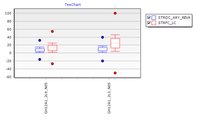

Hello SNPSUSER,
The chart your describe is achievable. It needs a little setting up and the concept division between point and series should be blurred. Adapting Yeray's code from his example, you would need to set up an array of the axis labels you require and decide what point (series) relationships to make so that the Checkbox click on the Legend activates/deactivates all required series.
That gives a Chart that looks like this:
Use the Series position value to shift x-axis positions as more Series-Points are added to each Axis location. It is not necessary to use an array to control it as in this example; it could be calculated generically.
I hope that may be of help.
