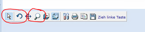

I’m currently trying to implement a teechart-chart into our application’s new gui. Instead of using the tee-commander controlling the functions of the chart, I’m building my own menu with selected menu-actions of the tee-commander.
Is it (or how is it) possible to access the commander’s methods (e.g. rotate and zoom)? What I’m trying to achieve is having my own button for rotating the chart just like the rotate button on the tee-commander does.

The easiest way for the rotation would probably be using a TRotateTool, and activate/deactivate it through your button.
The buttons in the commander basically set move/rotation modes. These modes use the mouse events to modify the Chart's Aspect Rotation/Elevation properties for the Rotation, and the HorizOffset/VertOffset for the Move.

I'm still trying to get this working the simple way.
In an older post here in the forum (http://216.92.243.79/support/viewtopic. ... 97a3a9f480) Yeray wrote, that that the "rotate" and "move" buttons are used as flags within the TeeChart Commander.
Is it possible to access these flags in order to have my buttons having the exact same behaviour as the TeeChart Commander's buttons have?

The only way I can think to have the exact same behaviour is by using it, hidden. Ie:
TeeCommander1.Hide;
procedure TForm1.MoveButtonClick(Sender: TObject);
TeeCommander1.ButtonMove.Click;
TeeCommander1.ButtonMove.Down:=True;
procedure TForm1.DepthButtonClick(Sender: TObject);
TeeCommander1.ButtonDepth.Click;
TeeCommander1.ButtonDepth.Down:=True;
procedure TForm1.ZoomButtonClick(Sender: TObject);
TeeCommander1.ButtonZoom.Click;
TeeCommander1.ButtonZoom.Down:=True;
