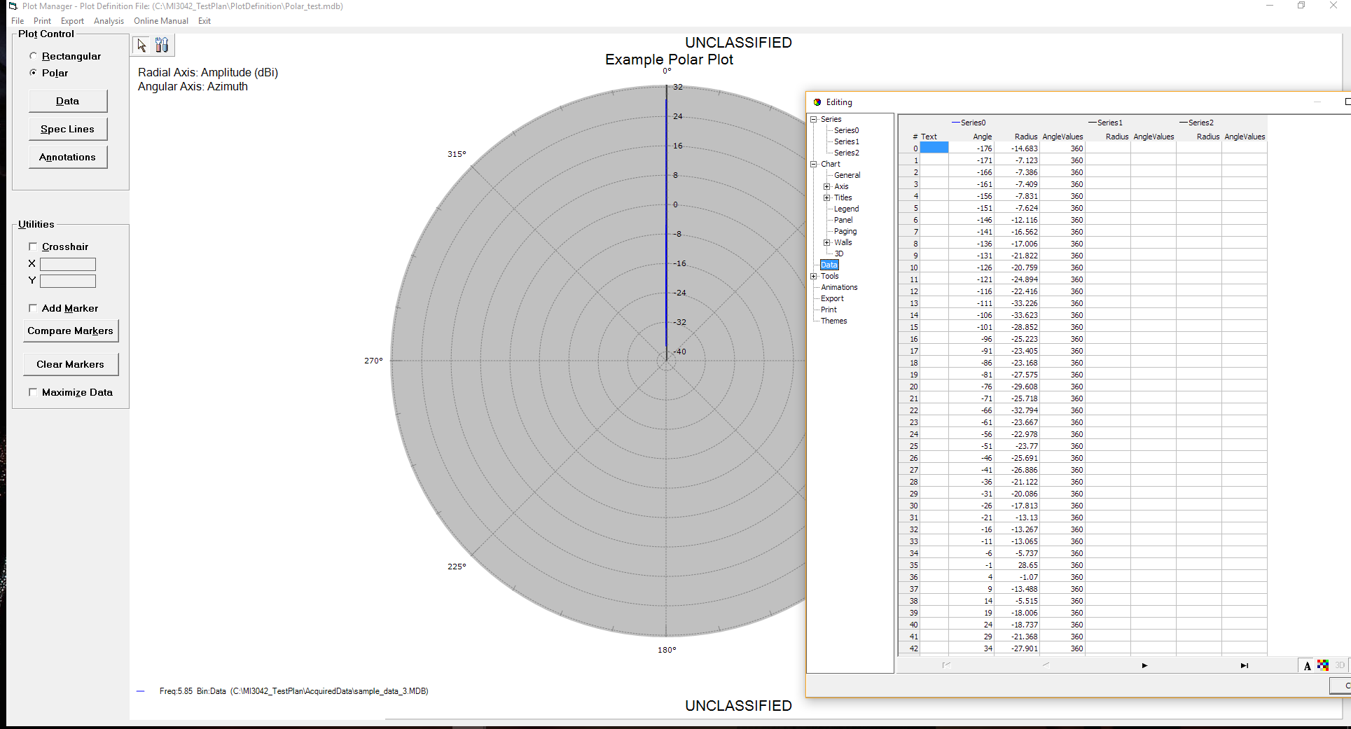

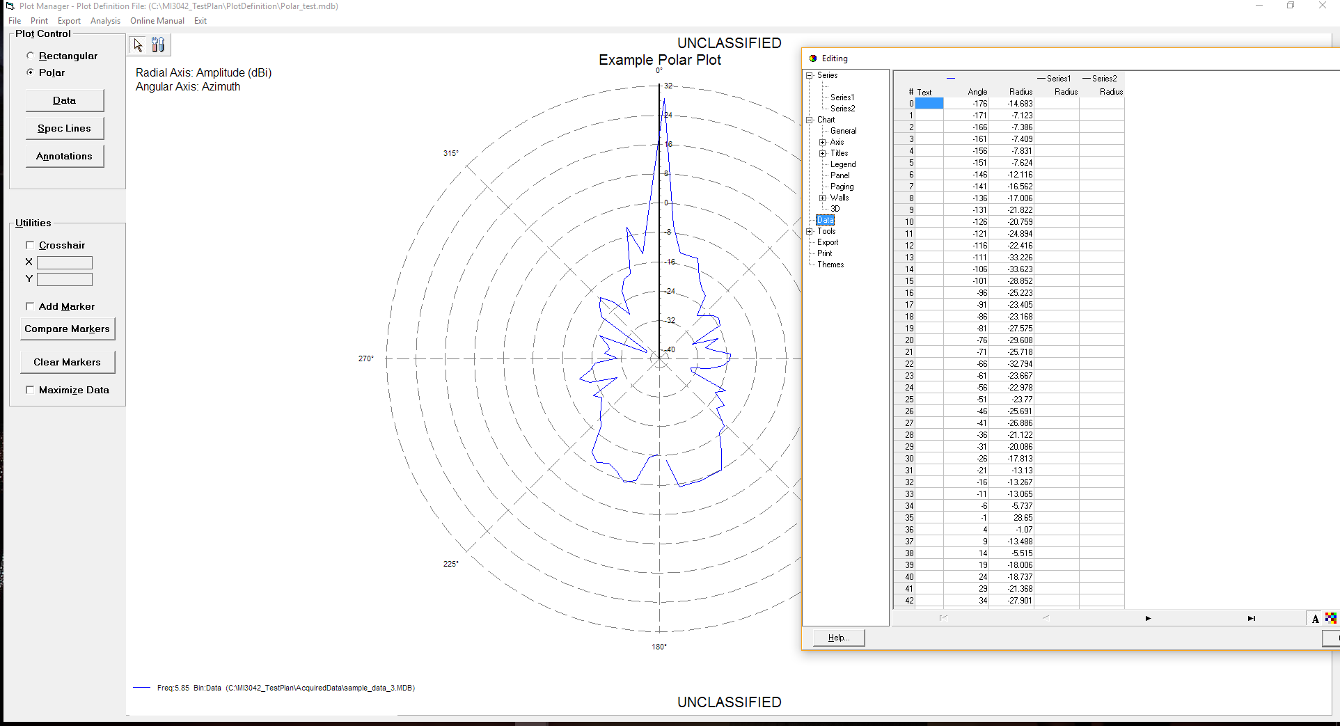

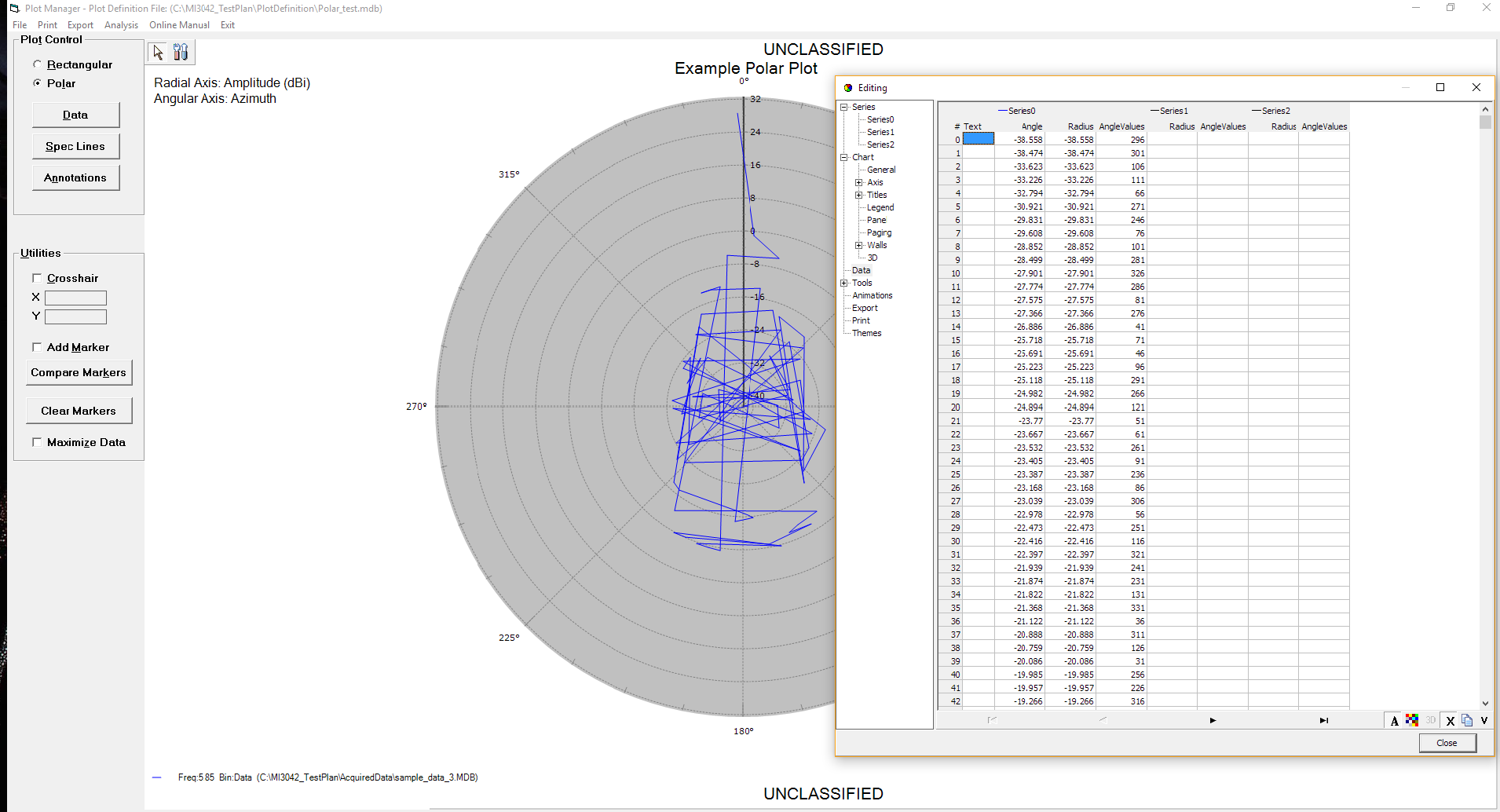

I am upgrading my VB6 application from TeeChart V8.0.0.5 to TeeChart 2016.0.0.2 due to printing problems in Version 8 and Windows 10. Since upgrading to TeeChart 2016 my print issues have been corrected but now my polar plots will not display the correct data. See attached pictures showing the polar plot for TeeChart 8 and polar plots for TeeChart 2016.
With TeeChart 8, I used AddArray to add the data to the Series. With TeeChart 2016 first picture I used AddArray and second picture I have tried Add Polar and still cannot get the correct plot.

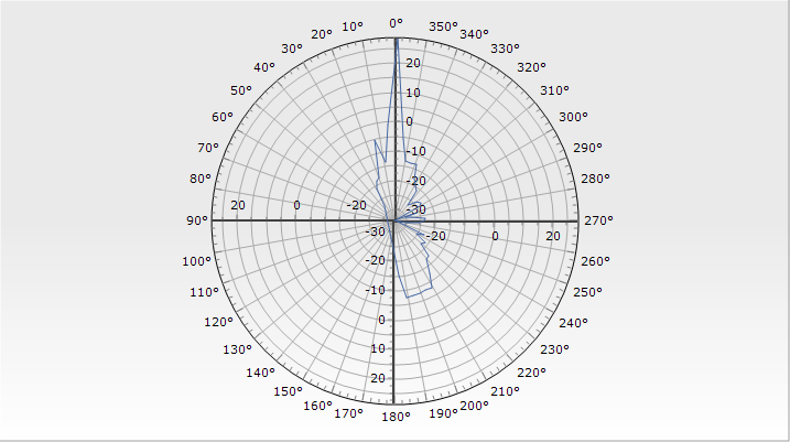

And I get the same result you were getting with TeeChart ActiveX v8:
So I'm not sure to understand how are you exactly adding those points. If you still find problems with it, please try to arrange a simple example project we can run as-is to reproduce the problem here.

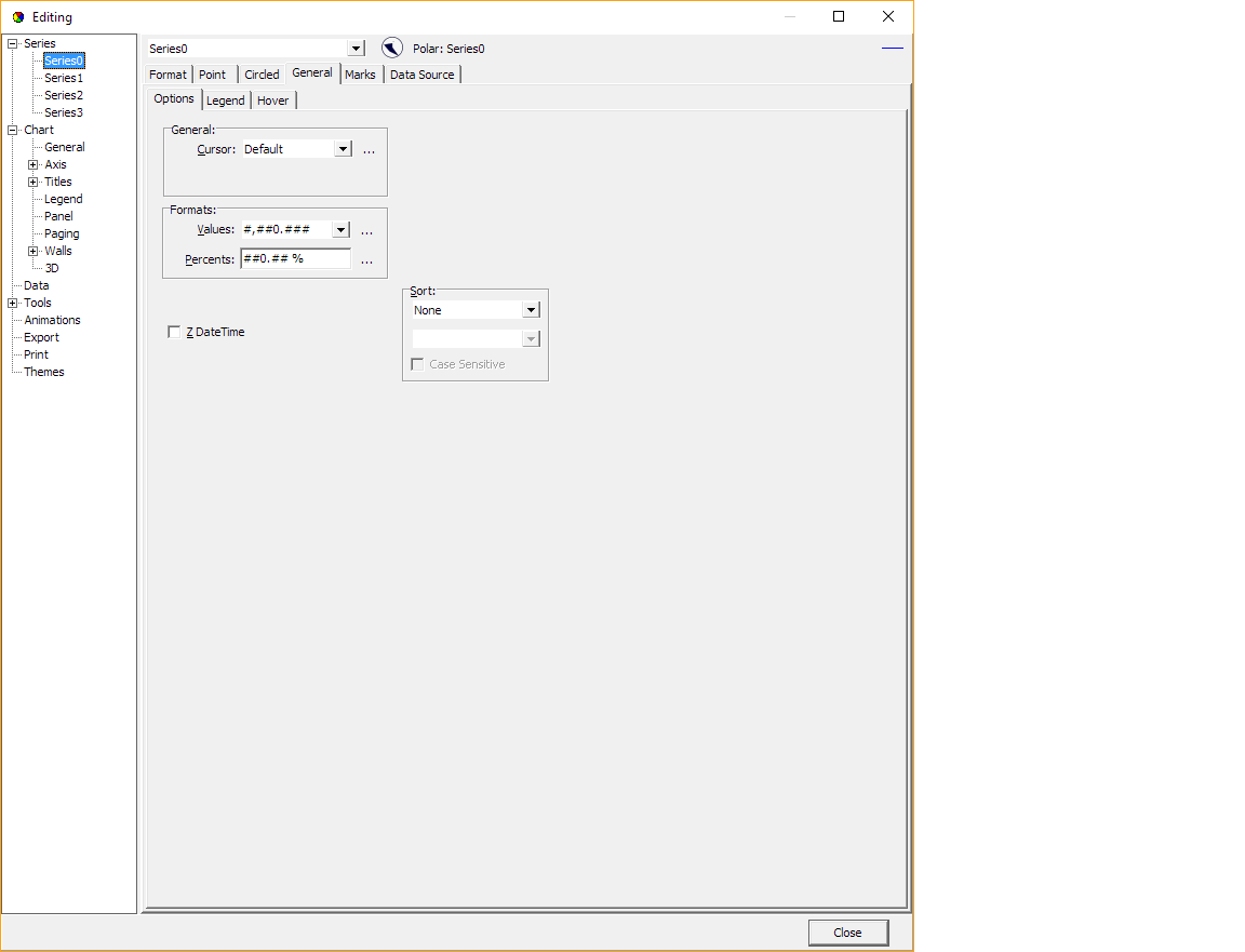

I think I found why my data looked was wrong. Under Series General Tab, my data was sorted. How do I set the sort to None?
Series - General Tab
Series General tab.png (22.24 KiB) Viewed 13813 times
Re: Issue with Polar Chart
Post by Yeray » Mon Oct 31, 2016 9:39 am
You can try with this:
TChart1.Series(0).XValues.Order = loNone
If you still find problems with it, try to arrange a simple example project we can run as-is to reproduce the problem here.

Thank you that worked
