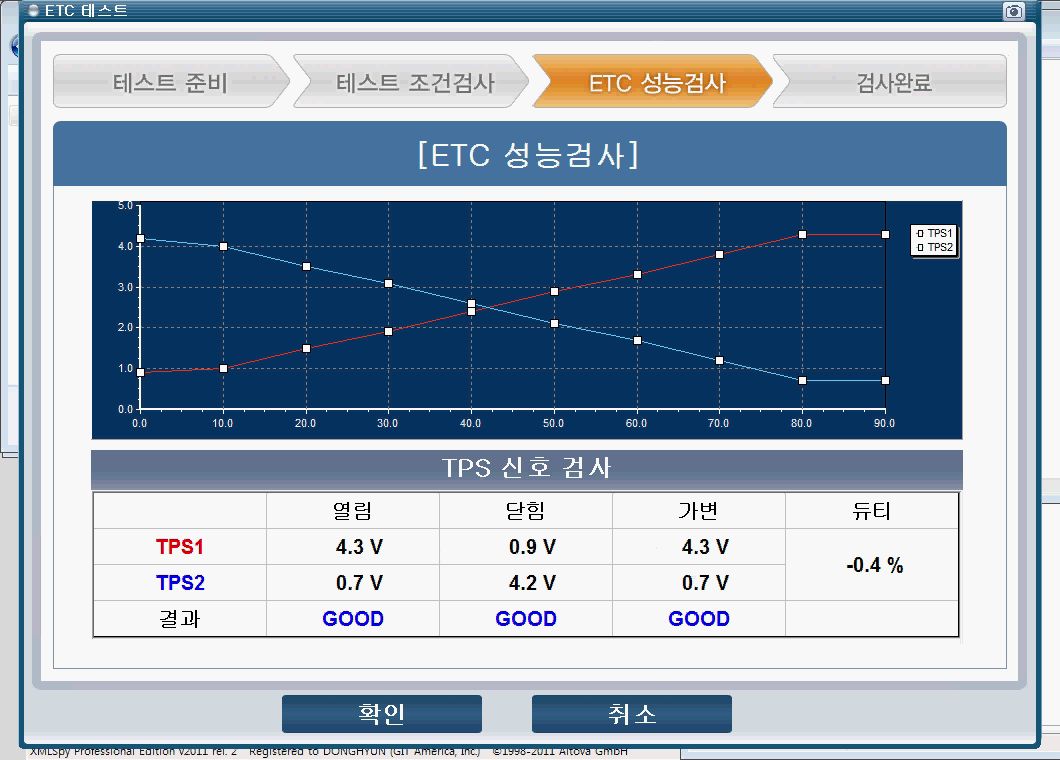

It worked well when we used TChart Control v8.0.0.1.
Since Windows 10 RedStone version, it has been unable to register the registry.
After updating it to v8.0.1.3, it worked well on Windows 10 RedStone but a problem occured on Windows 7.
The problem is line color on the Graph does not change.
The attached file is a sample program and existing program screen.
Please check it out and reply to us.
Thank you for your kind cooperation.

GIT wrote:The problem is line color on the Graph does not change.
I'm not sure if the problem is in the lines and the image you attached shows the desired result or if the problem is that the pointers are white.
If the problem is in the lines, try changing the code in where you are adding points (in the timer) for this:
		m_TChart1.Series(0).AddXY(m_nData-1, (m_nData/2), L"", m_TChart1.Series(0).GetColor());
		m_TChart1.Series(1).AddXY(m_nData-1, (m_nData/2)+1, L"", m_TChart1.Series(1).GetColor());
If the problem is in the pointers, just remove the part where you are assigning them to be white:
	//m_TChart1.Series(0).GetAsLine().GetPointer().GetBrush().SetColor(RGB(255,255,255));
	//m_TChart1.Series(1).GetAsLine().GetPointer().GetBrush().SetColor(RGB(255,255,255));
