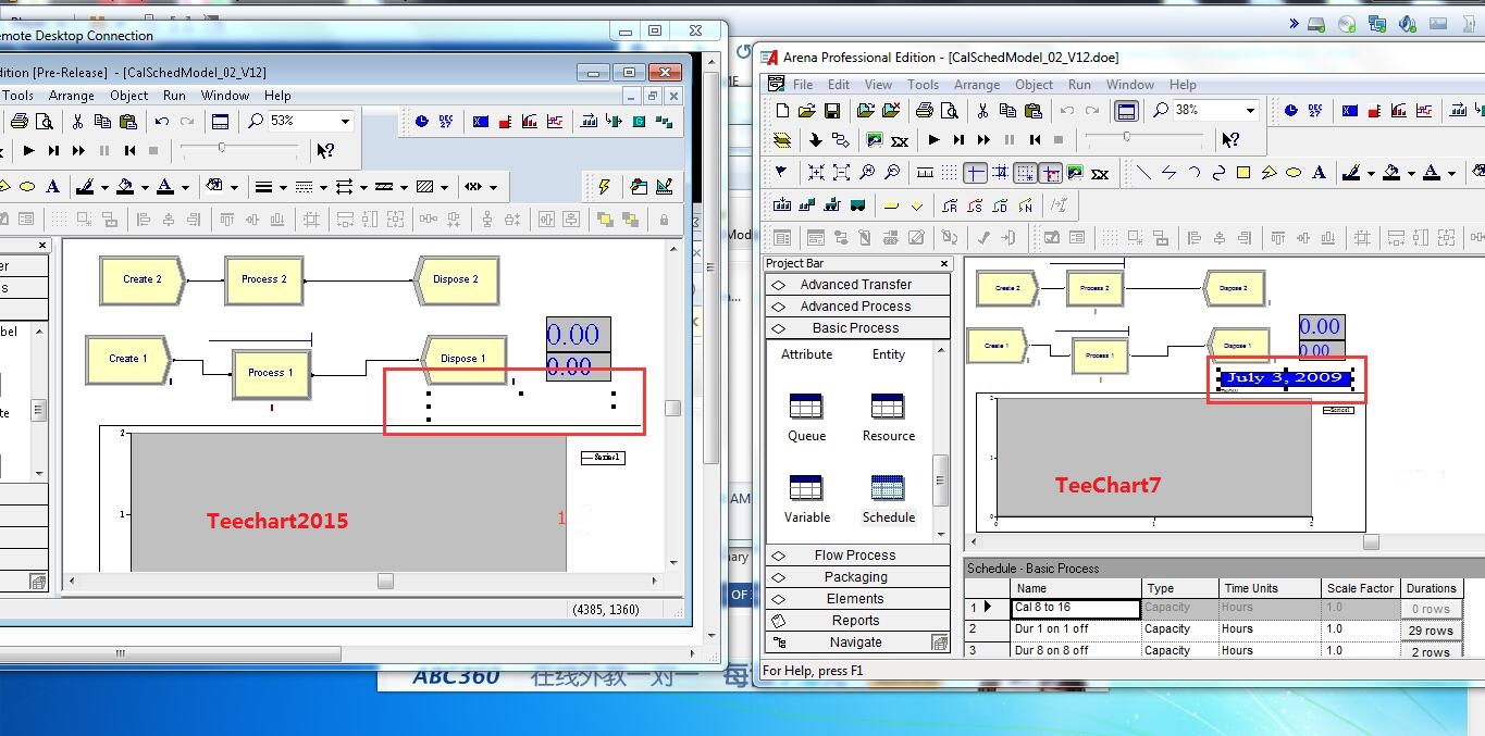

That causes some display issue. It can’t display normally itself and affect other objects' displaying in model(please see the attachment "TeeChart2015 affect other objects.jpg"). After a long time of investigating, I figure out the root cause, the code ‘m_pChart->GetCanvas()->PutUseBuffer(VARIANT_FALSE);’. When setting this property to VARIANT_TURE, the display issue was almost fixed except TeeChart still displays with a wrong border. But it cause another issue, the speed issue. When running the model the speed becomes very very slowly. Actually, the ‘UseBuffer’ value is used to control the speed of drawing TeeChart. It seems we can’t let it display normally and keep the normally speed at the same time. Then I tried to set ‘UseBuffer’ property to VARIANT_FALSE before drawing teechart and setting to VARIANT_TURE after finishing drawing TeeChart.

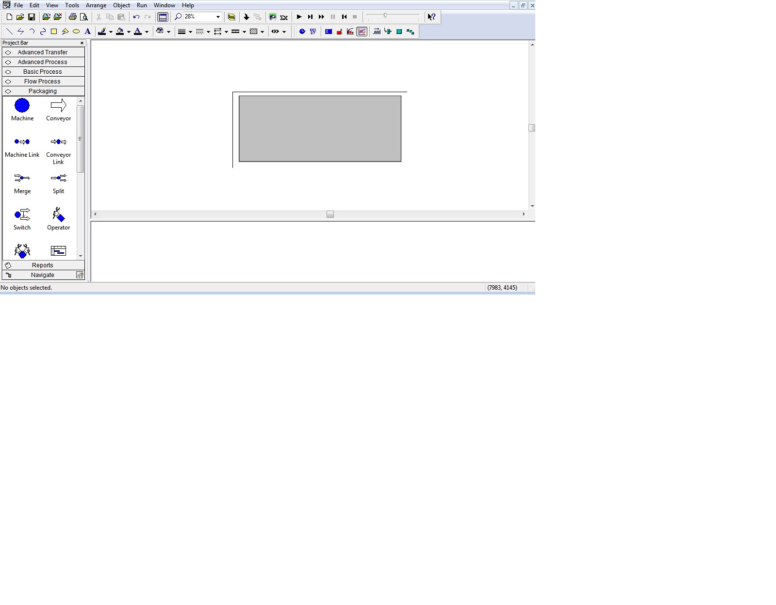

1. TeeChart still displays with a wrong border(missing one or two edge(please see attachment "TeeChart2015 disaply unnormal.jpg"), it can display well sometimes).
2. The running speed of model becomes more slowly.

- TeeChart2015 affect other objects's displaying in my model.
- TeeChart2015 affect other objects.jpg (266.88 KiB) Viewed 9159 times
- The border of TeeChart2015 disaplys unnormally
- TeeChart2015 disaply unnormal.jpg (124.73 KiB) Viewed 9150 times

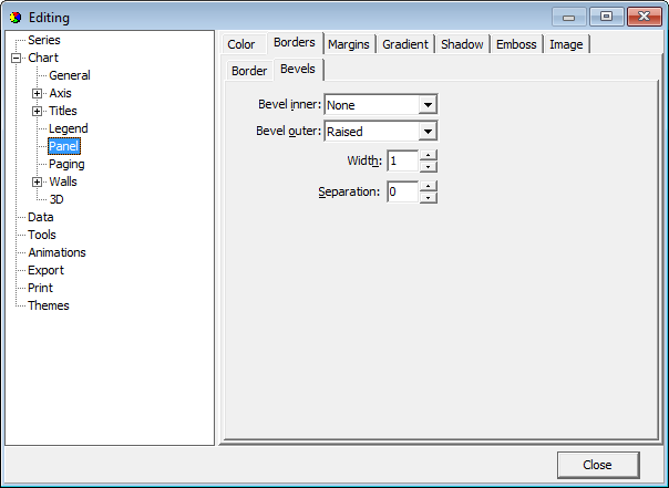

Have you tried playing with the bevels?Arena wrote:1. TeeChart still displays with a wrong border(missing one or two edge(please see attachment "TeeChart2015 disaply unnormal.jpg"), it can display well sometimes).
