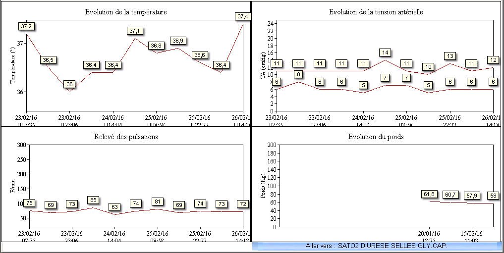

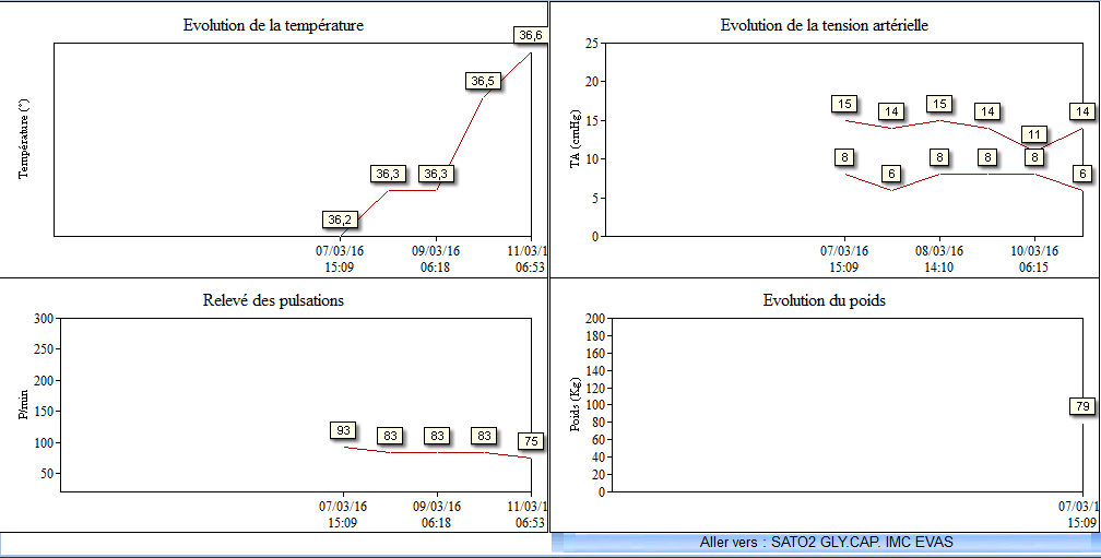

Someone can help me to fix the text on axis ?, the label is cut.
I can't enlarge the graph.
I use the method AddXY to write the graph.
I appends the date and time in the parameter "label".
thanks for your help
bye

Hello
Don't work with
TChart1.Axis.Bottom.MinimumOffset = 10
TChart1.Axis.Bottom.MaximumOffset = 10
but i use this method
TChart1.Panel.MarginBottom and it's ok now
Thanks for help
