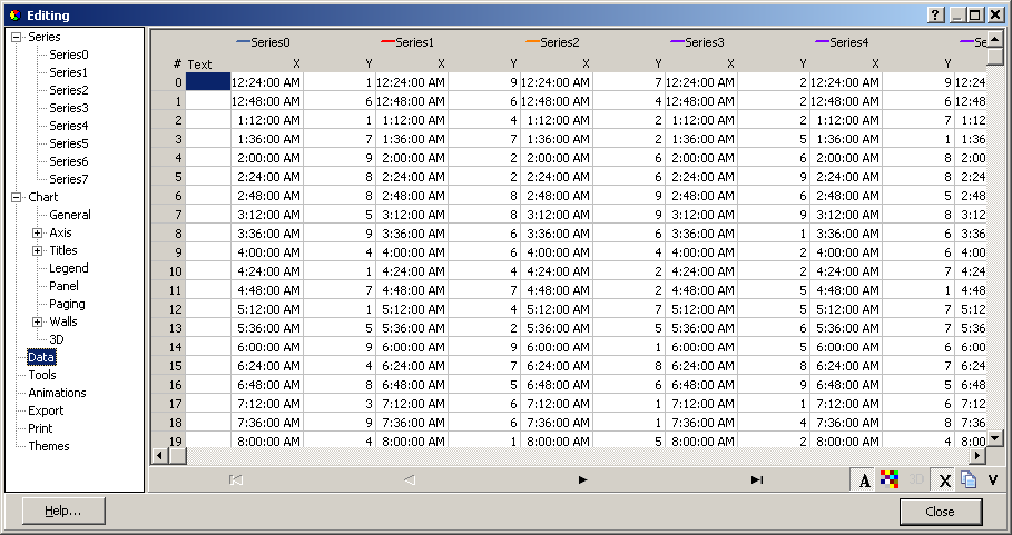

Using Tchart1.ShowEditor, the X Data is as follows:
Accumulated Mode: 0, 0.017, 0.033, 0.05, etc..
Real Time 12 Hr.: 12:00:00 AM, 12:24:00 AM, 12:48:00 AM, 1:12:00 AM, 1:36:00 AM ......
Real Time 24 Hr.: 12:00:00 AM, 12:24:00 AM, 12:48:00 AM, 1:12:00 AM, 1:36:00 AM ......
The Accumulated Mode displays the traces as expected (Correct X Value).
The Real Time Modes display the traces well beyond the end of the graph (Incorrect X Values).
The Y Values for all 3 modes appears to be correct.
As I toggle through each of the different modes, and examine the data with the ShowEditor, the X Values remain constant as listed above.

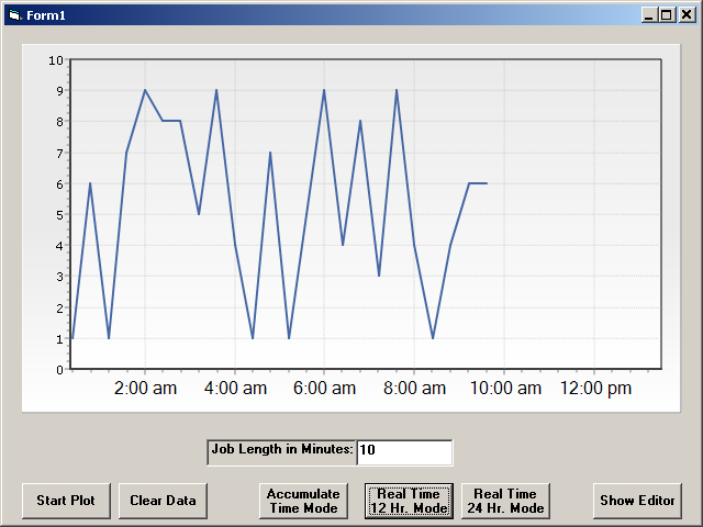

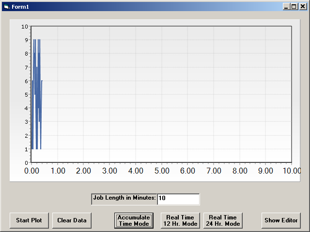

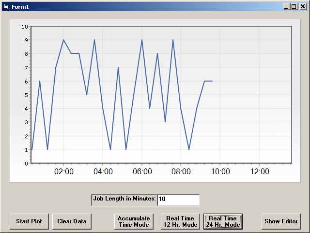

I tried the .Labels.Style setting, but this is not what I'm trying to accomplish.
I have included screen shots in an effort to describe the issue.

tirby wrote:Accumulated Mode:
Bottom Axis is correct.
Note X Column Data:
Data is correct.
Real Time 12 Hr. Mode:
Bottom axis is incorrect and should read:
(Now – What-ever the current time is.)
11:55 am 11:56 am 11:57 am 11:58 am 11:59 am 12:00 pm 12:01 pm 12:02 pm 12:03 pm 12:04 pm 12:05 pm
Also, the graph is spread out to over half of the chart. Width should not have changed.
Note the X column data:
Should be the same as the Bottom Axis labels. Note that the times skip by 24 Minutes.
Real Time 24 Hr. Mode:
Bottom axis is incorrect in a similar manner as the 12 Hr. Mode.
The data is the same as the 12 Hr. Mode data.

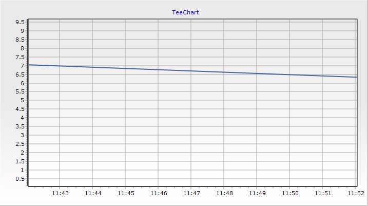

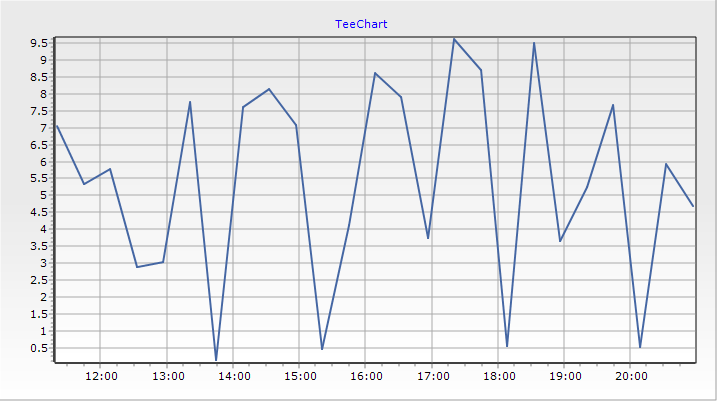

I've made a simple example showing a result similar to yours. The code below gives me this:
Here the code to produce it:
Private Sub Form_Load()
  TChart1.Aspect.View3D = False
  Dim i, j As Integer
  Dim tmpStart, tmpDate As Date
  tmpStart = Now
  For i = 0 To 3
    TChart1.AddSeries scLine
    TChart1.Series(i).Pen.Width = 2
    TChart1.Series(i).XValues.DateTime = True
    For j = 0 To 24
      tmpDate = tmpStart + (1 / 24 / 60) * 24 * j
      TChart1.Series(i).AddXY tmpDate, Rnd * 10, "", clTeeColor
    Next j
    If i > 0 Then
      TChart1.Series(i).Active = False
    End If
  Next i
  'TChart1.Axis.Bottom.SetMinMax tmpStart, tmpStart + (1 / 24 / 60) * 10
Note the last line is commented. If you enable it you'll see that changing the bottom axis scale makes the labels to show an increment of one minute:
