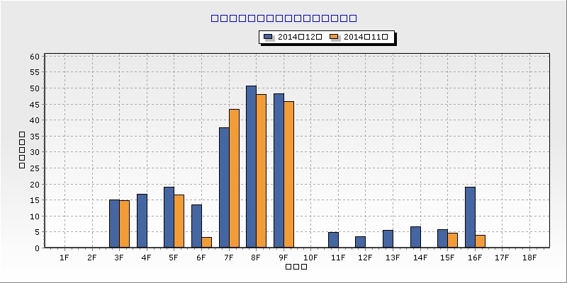

Chinese char with messy code
Post by hansan » Mon Feb 02, 2015 9:39 am
I have a problem as follow picture,the server OS is windows2008 simple Chinese and teechart version is 2012axtivex

I observing this problem with TeeChart2012_0_0_9ActiveX3264.I run the program in Visual Studio it show the Chinese chars,but when I deployed it on IIS the messy codes apeared.

Hey,I have solved the problem.In the codes I confirmed the font name for the Chinese chars,and the messy code disappeared.
