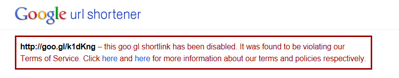

Re: TeeChart2014.0.0.2 in Japanese system
I got the email but the link is not ok.
See the attached image:
[img]LinkNotOk.PNG[/img]
- LinkNotOk.PNG (14.03 KiB) Viewed 38907 times
Excuse me. I'm sending it again.
Thank you.I managed to download it.
But, my demo is still crashing the same way.
This happens only in Japanese Windows.
