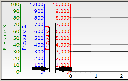

I'm trying to set the position of the Axis Label with respect to the axis.
If I have the Axis scaled for 0 to 1000 and marks every 100, then the spacing between the label and the values is too great.
We want to reduce the spacing to something less.
How can I accomplish this?
Thanks!

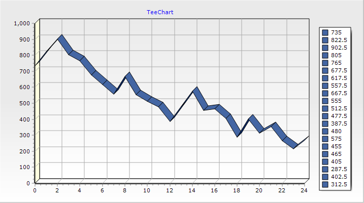

I'm not sure to understand what exact distance do you mean.
This is how it looks for me here:
Private Sub Form_Load()
  TChart1.AddSeries scLine
  TChart1.Axis.Left.SetMinMax 0, 1000
  TChart1.Axis.Left.Increment = 100
What space do you want to reduce?

Post by tirby » Wed Jan 07, 2015 2:34 pm
Yeray,
Thanks for looking at this.
What I'm trying to do is change the spacing between the the 2 black arrows as shown on the picture below.
Re: Set Position of Axis Lable
Post by Yeray » Thu Jan 08, 2015 2:38 pm
I'm afraid you can't control the axis title position.
Instead, you could hide the axis title and draw its text manually as follows:
  With TChart1.Axis.Left
    XPos = .Position - .Labels.MaxWidth - .TickLength
    YPos = .IStartPos + ((.IEndPos - .IStartPos) / 2) + (TChart1.Canvas.TextWidth(.Title.Caption) / 2)
  End With
  With TChart1.Canvas
    .RotateLabel XPos, YPos, TChart1.Axis.Left.Title.Caption, 90
  End With
