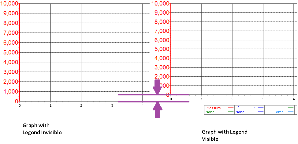

On the picture below, I have place 2 screen-shots side by side.
I aligned the tops of the grids.
The picture on the left has the Legend set to invisible.
The picture on the right has the Legend set to visible.
Note the positions of the "0" lines.
The difference is highlighted by the purple lines and arrows.
What I need to have happen is regardless of the visible state of the Legend, the Height of the grid needs to remain the same.
Is this more clear now?
Thanks!
Thank you for reviewing this.
Thanks!

Re: Determine Height of Legend
Then, you should set the legend CustomPostition to true and set both the legend position and the chart margin manually. Ie:
TChart1.Aspect.View3D = False
Dim i As Integer
For i = 0 To 4
TChart1.AddSeries scLine
Next i
TChart1.Legend.Alignment = laBottom
TChart1.Legend.CustomPosition = True
TChart1.Legend.PositionUnits = puPixels
TChart1.Legend.Top = TChart1.ChartBounds.Bottom - 30
TChart1.Legend.Left = 80
TChart1.Panel.MarginBottom = 10
