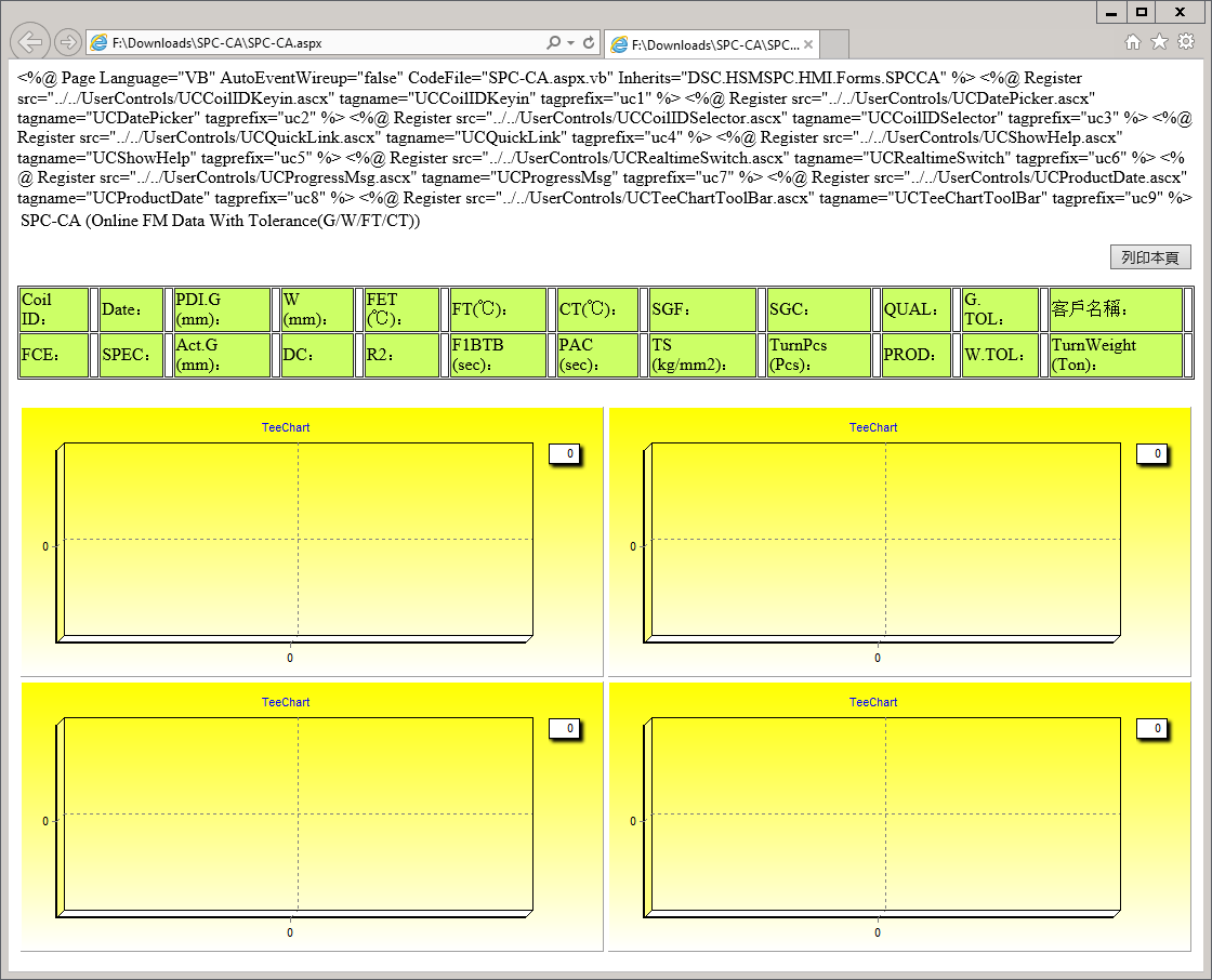

There are UserControls and css files that are referenced but I don't have them here, so this example don't look as self-containing.
Also, it consists on 3 files, more than 2700 lines of code, so this example don't look as short.
Please, read the instructions below in my signature. You'll find a this link to an explanation about what a Short, Self Contained, Correct (Compilable), Example is.
Anyway, I've opened SPC-CA.aspx with IE11 and I get this:
I can put other windows in front of this page and the 4 charts always seem to be shown correctly for me here.
