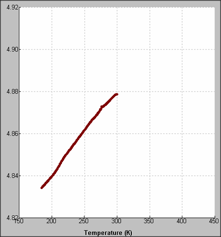

Hy guys.
I am trying to have a chart where the grid lines are fixed, but even using increment property teechart does decide where to put the grid lines and sometimes the first gridline at the bottom does not coincides with the Min value I set and this gives less the 6 labels at the axis.
What I want is to replicate the behavior as shown in the image attached.
Left axis divided in 5 parts, and always displaying 6 labels, with some offset in order to avoid data point near the axis.
Snap 2014-10-20 at 09.07.08.png (35.84 KiB) Viewed 30740 times

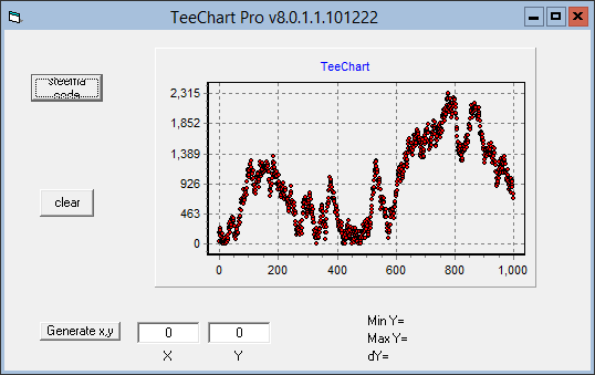

If I click "Generate x, y" button, then I can click "steema code" button many times, always getting a good looking chart.
However, I've modified the code in your Command3_Click a little bit because you don't need to create a new Point series if there's already one created, and because you are setting the left axis to be "automatic=false" at Form_Load so it wasn't calculating correct minimum and maximum if you never click "Generate x, y" button, where it set "automatic=true".
So with the code below, the charts produced with your application look always as in the image below, just clicking the "steema code" button again and again.

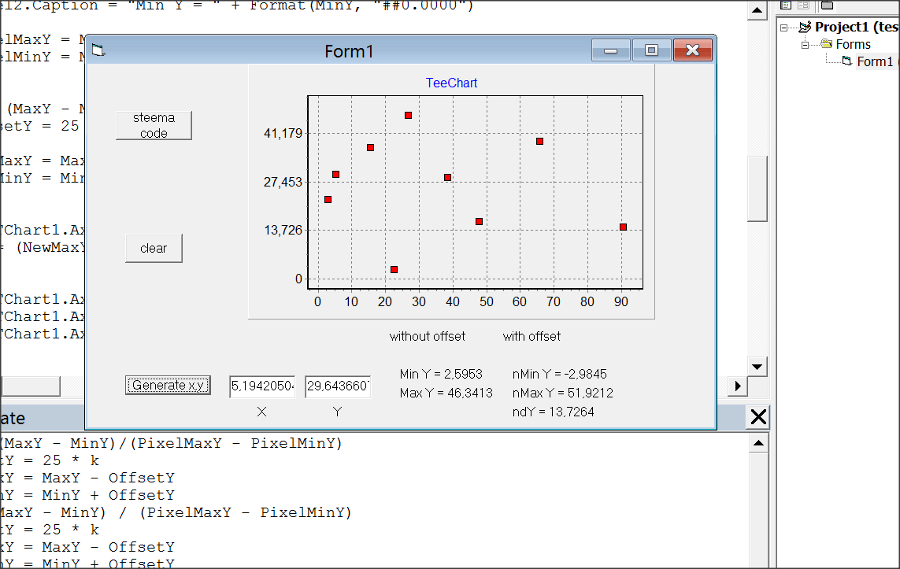

I have been working on it and my code now calculates the final value for the Ymax and Ymin considering the offset, but the problem persists, because teechart chooses by itself where to put the gridlines despite I use SetMinMax and Increment properties , I dont have or I dont know how to control this behavior. An example is the new image below. I attached the new code too.
snap today2.png (142.88 KiB) Viewed 30640 times
Sorry for the large image !
See the values calculated with the offset and the increment calculated ?
I have set the MinMax property to the values and the increment to the ndy, considering an offset of 25 pixels. Now look at the chart. Where is the first grid line(from the bottom) ? It is at the Y=0 and not at the y=-2.9845, if it was at -2.9845, with the calculated increment I would have 5 labels at the axis instead of 4 as showed.
ntest.zip
(45.67 KiB) Downloaded 2046 times

The same occurred in your chart. The first grid line was chosen by teechart to no start at bottom axis, but at the 0 in your chart.
