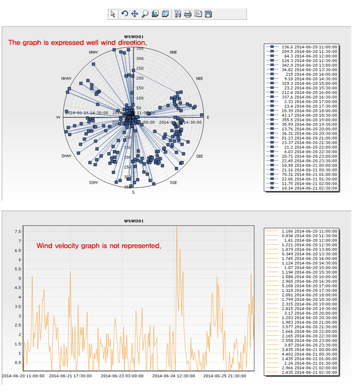

I could not find a graph that represents the direction of the wind and wind velocity at the same time an example.
How can i fix this coding.. help me..

I'm not sure to understand what's wrong in the resulting images you attached. Could you please explain what result would you expect?

Hi~
It's not result image... ^^;;;
it's want results....
and it's only one page source.
above image --- OK
below image ---- do not express

I'm still not sure to understand what exact result would you expect.
I see the first chart seems to draw date times in the horizontal axis of the WindRose series, but I don't know if this is what you'd expect, what are setday and data2, what are they supposed to represent and which one is correctly represented in the image you posted, if any.
And the same for sday and data in the second chart.
Note the XValues in the WindRose represent the angle, and the YValues represent the radius of each point.
So, if you want to add points with angle and value, you should use AddXY. Ie:
  TChart1.AddSeries scWindRose
  TChart1.Series(0).AddXY 15, 50, "", clTeeColor
  TChart1.Series(0).AddXY 30, 70, "", clTeeColor
  TChart1.Series(0).AddXY 45, 30, "", clTeeColor
