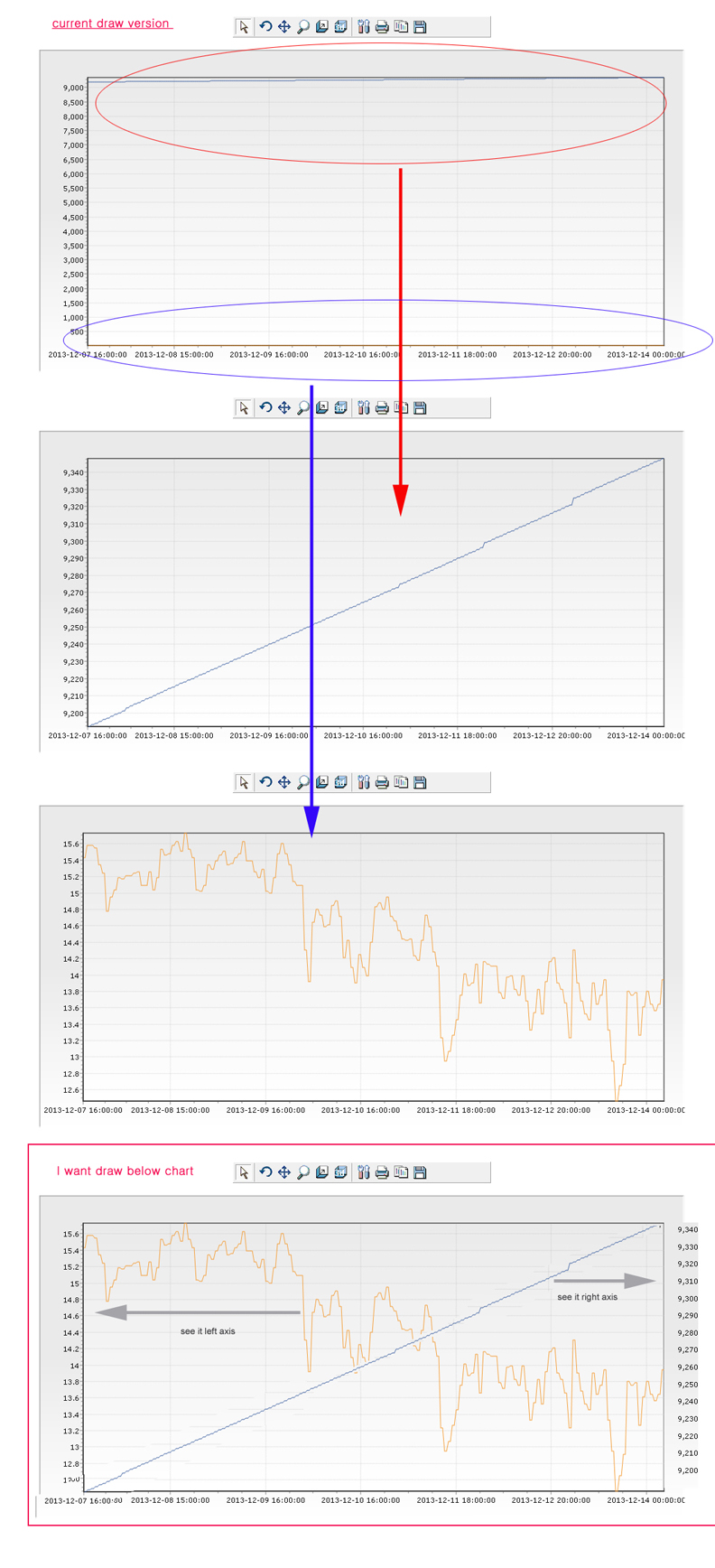

I would like to refer to the Right Y-axis and the graph. See this remarkable document or sample?

If you want use the two vertical axes, you need only set the VerticalAxis property of Series to both. See code below as example:
Private Sub Form_Load()
TChart1.Aspect.View3D = False
TChart1.AddSeries (scFastLine)
TChart1.Series(0).VerticalAxis = aBothVertAxis
