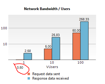

In a BarChart the Marks when a value is too small it is showed under the bar not on top of it like for the other values.
You can see in the attached picture.

I can't reproduce this with the following code:
  TChart1.Aspect.View3D = False
  TChart1.AddSeries scBar
  TChart1.Series(0).AddArray 3, Array(0.5, 5, 50)
  TChart1.Series(1).AddArray 3, Array(2.58, 25.83, 258.33)
Could you please modify the code above so we can reproduce the problem here?
Alternatively, could you arrange arrange a simple example project we can run as-is to reproduce the problem here?

I forgot to mention. The Y-Axis is Logarithmic.

Try setting this:
TChart1.Series(0).Marks.Clip = True
TChart1.Series(1).Marks.Clip = True

With this line it does not show the Mark at all.

Please, try to arrange a simple example project we can run as-is to reproduce the problem here because I can't with the following code and TeeChart v2014.0.0.1:
  TChart1.Axis.Left.Logarithmic = True
