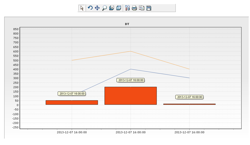

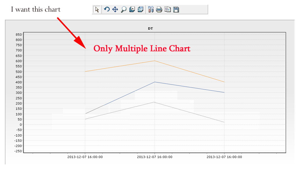

Hi~ I need Multi line chart therefore ASP codeing in below :o
How can i fix it.. Help me.. :cry:
Set Chart1 = CreateObject("TeeChart.TChart")
Chart1.Legend.Visible=false
Chart1.Header.Text(0)= tag_no
Chart1.Header.Font.Color=vbBlack
Chart1.Header.Font.Bold=True
Chart1.AddSeries(Line)
Chart1.Aspect.View3D=False
Chart1.Panel.Gradient.Visible=false
Chart1.Panel.Color=black
Chart1.Panel.BevelOuter=1
Chart1.Panel.BevelWidth=2
Chart1.Axis.Bottom.Labels.Angle=0
Chart1.AddSeries(0)
Chart1.AddSeries(1)
Chart1.AddSeries(2)
setday = res("sday")
data = res("data")
Chart1.Series(0).Add 100, setday, clTeeColor
Chart1.Series(0).Add 400, setday, clTeeColor
Chart1.Series(0).Add 300, setday, clTeeColor
Chart1.Series(1).Add 500, setday, clTeeColor
Chart1.Series(1).Add 600, setday, clTeeColor
Chart1.Series(1).Add 400, setday, clTeeColor
Chart1.Series(2).Add 50, setday, clTeeColor
Chart1.Series(2).Add 200, setday, clTeeColor
Chart1.Series(2).Add 10, setday, clTeeColor
Response.BinaryWrite (Chart1.Export.asNative.SaveToStream(True))

Post by Yeray » Tue Jun 17, 2014 2:45 pm
rush kim wrote:Hi~ I need Multi line chart therefore ASP codeing in below :o
I see this in your code:
Chart1.AddSeries(0)
Chart1.AddSeries(1)
Chart1.AddSeries(2)
First note the argument in the AddSeries method is the series type you want to create.
Secondly, note type 0 is a Line series, type 1 is a Bar series, and type 2 is an HorizBar series.
If you want to add 3 Line series, change the code above for this:
Chart1.AddSeries(0)
Chart1.AddSeries(0)
Chart1.AddSeries(0)
These and other constants can be found at the TeeChartDefines.h file in the "\Utilities\New VC Classes" folder of your TeeChart installation.
