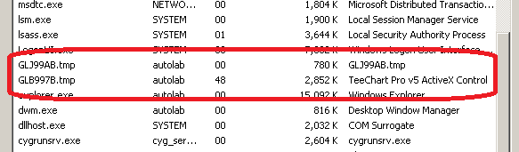

When I check in the task manager the process is running but the process halts here.
[attachment=0]Task Manager.png[/attachment]

Hi Imran,
First of all note the last maintenance release of TeeChart v5 was published on March 2004 (more than 10 years ago!).
And Windows 7 was released on October 2009, so there were 5 years of time lag. This means TeeChart v5 ended it's life some time before Windows 7 was released.
Anyway, I've just downloaded TeeChart ActiveX v5.0.6.0 (released on October 2003), that was the last v5 complete release, and I could install it without problems in a Windows 8 x64 machine.
I'm preparing a VM with a clean installation of Windows 7 32bit and VB6 to check the same installer on it.

Hello Imran,
Maybe the install process is hanged for you due a problem there was in the old versions of TeeChartActivex with the printers are installed in the VM. See it in the thread. If it is the case, I would like suggest you disconnect printers as explain in this post to solve the problem.
Hoping we helps you.
