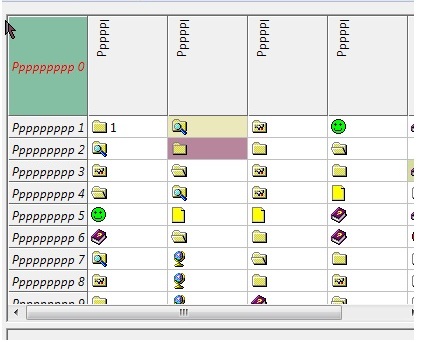

We are currently using T-Chart Active X-7 and want to implement a feature in the form of Grid view in which I need to insert image series as shown in figure below. I am not sure if T-Chart provides such feature. Please guide us if any solution is available.

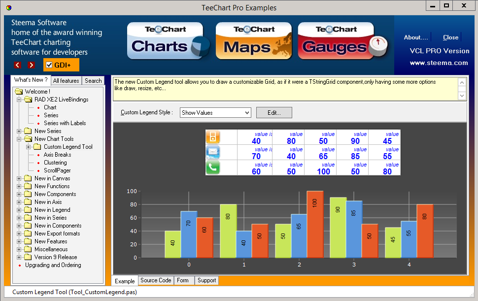

In this direction, you may be interested in the Custom Legend Tool, available for TeeChart VCL: Here it is how it looks:
However, I'm afraid some features are still missing in this tool for TeeChart ActiveX as you can read here.
