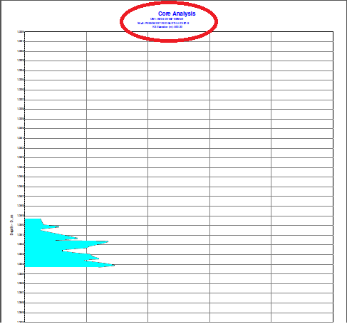

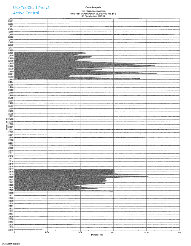

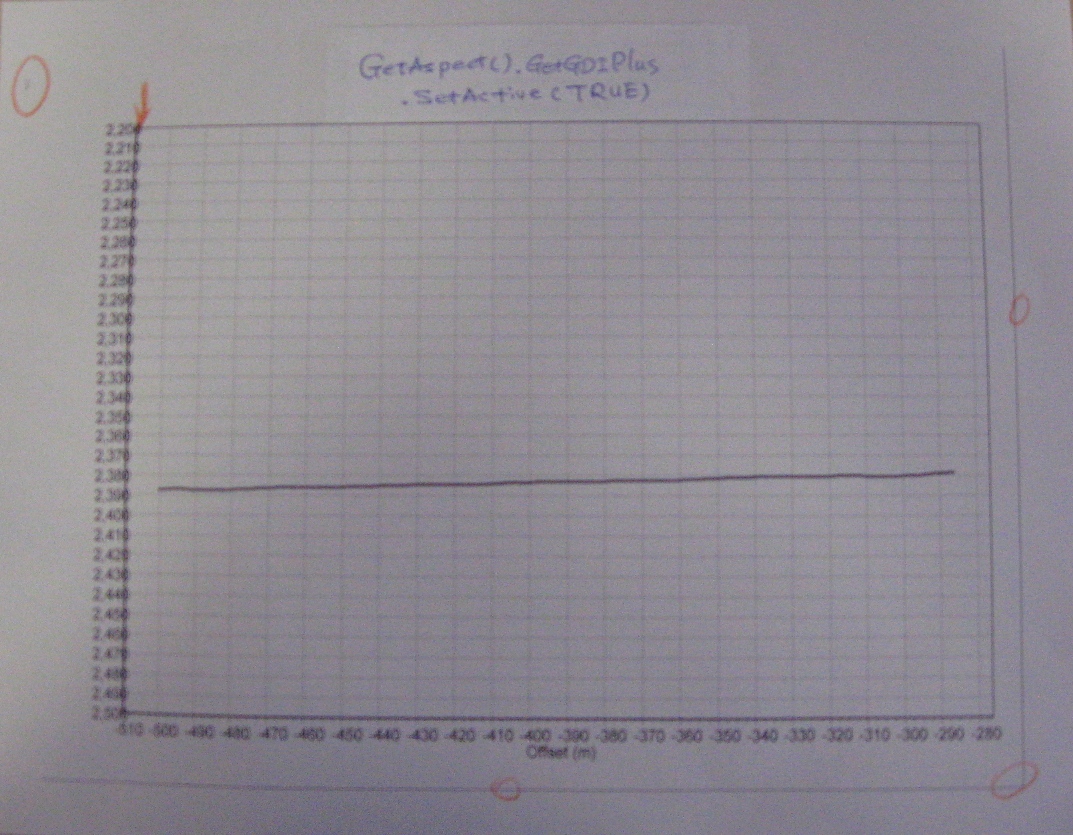

I have one existing application which was based on V505. After I updated the version to 2013, the printed labels/titles are off the axis to somewhere at the top-left corner and the font size is way smaller; the chart's titles are not lined up either, and the font size is smaller; border lines are drawn at the right and bottom.
- It was perfect to using TeeChart 5.
- DVT_TeeChart_5_Print.png (241.37 KiB) Viewed 34043 times
- Printing has problems including save it to PDF file.
- DVT_print_issue.png (122.27 KiB) Viewed 34008 times

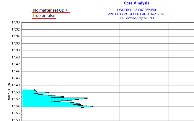

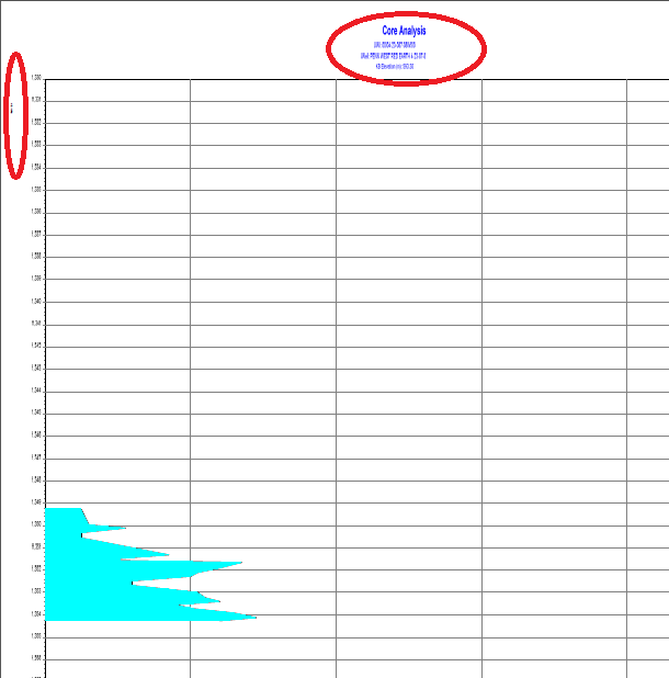

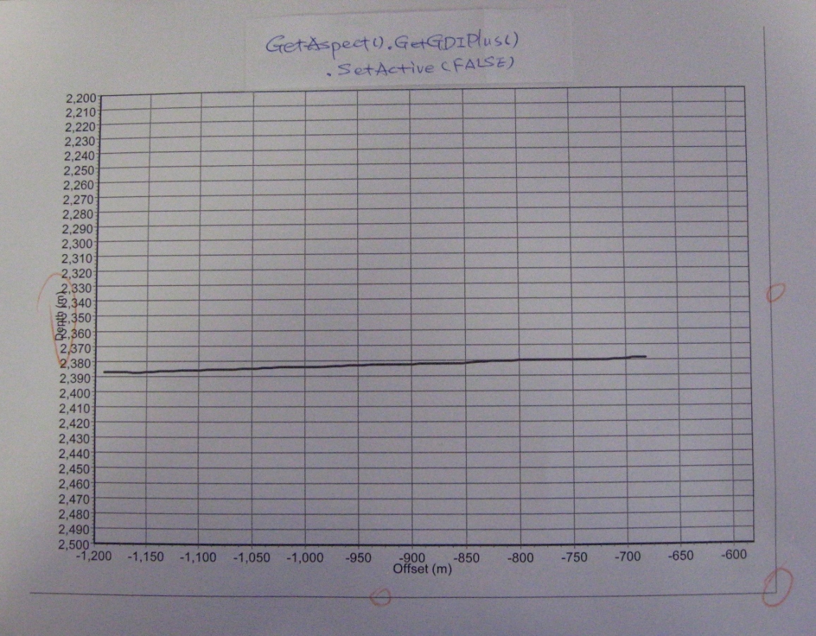

Today I tried your latest version (TeeChart Pro Activex Control v2014, v2014.0.0.2 Released on 20th November 2014). It looked like the issues were still not solved. I used it in an MFC project in Visual Studio 2012 (Win 7).
The attached shows the problems:
1. Axis's name (or title): it was printed at the top-left corner far away from the axis (should at the left-middle close to the axis's labels), if set GDI+ as true.
2. Axis's labels (numbers): they were to close to the plot (overlapped), if set GDI+ as true.
3. Axis's name (or tile): it was to close to the axis's labels and overlapped, if set GDI+ as false.
4. Extra lines: one lien on each of the bottom and the right edge, no matter GDI+ is set as true or false.
5. And the titles were still messed up (see the previous attachment DVT_print_issue.png)
The screen and preview were perfect.
- problems circled in red
- GDIplusTrue.JPG (421.56 KiB) Viewed 33703 times
- GDIplusFalse.JPG (486.78 KiB) Viewed 33711 times

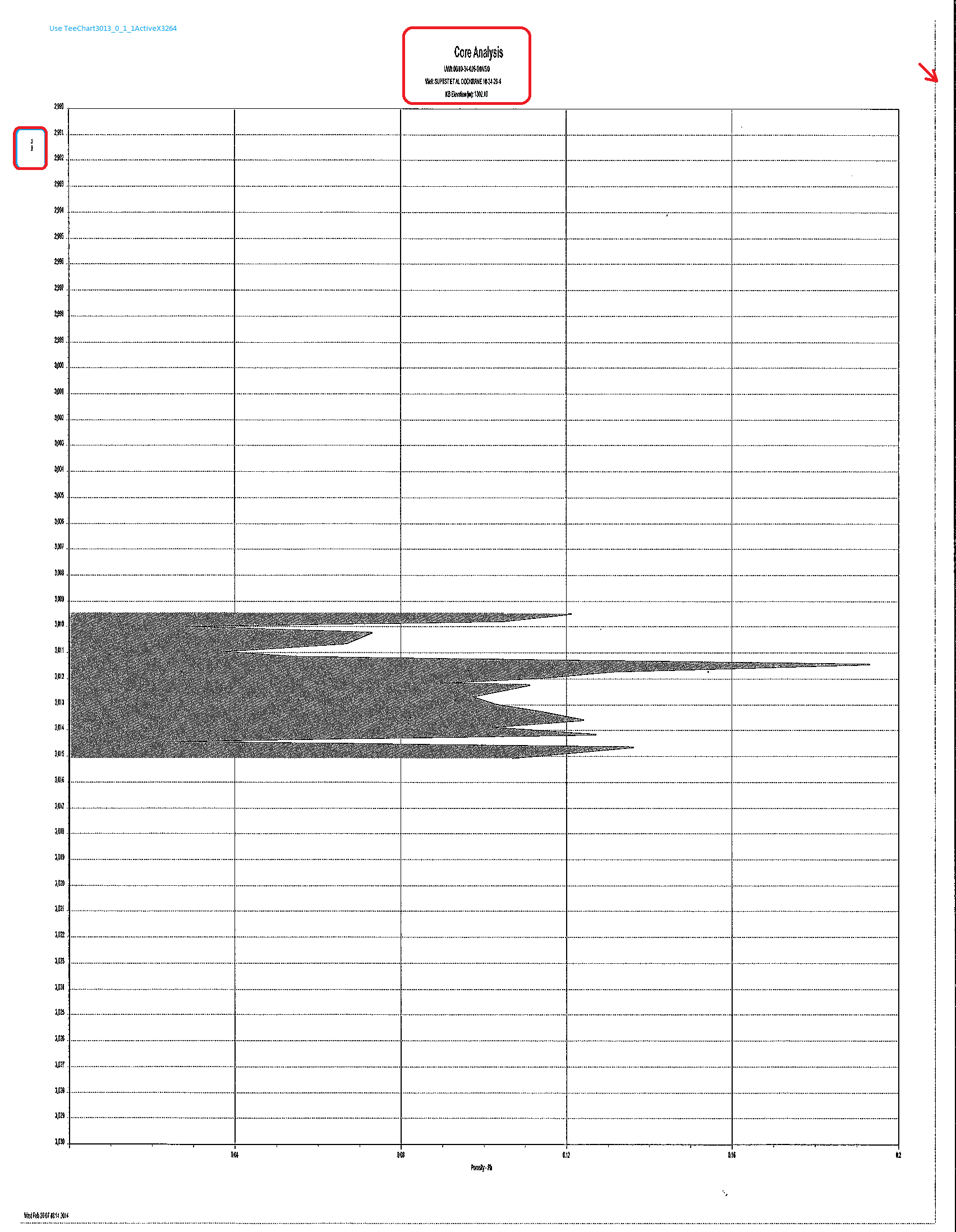

Re: Problem of Printing Axis' Labels and Titles
Yes. The problems are still persist.
1. After using the new TeeChart2014 (and 2013), the title on print out are not aligned properly, no matter set GDI+ true or false. It looks the exactly the same on screen as before.
1. On the pdf print out, it is the exactly the same result as on a paper print, the y-axis title is printed at the top-left corner and the font is way smaller and hard to see.
See the attachment.
See the attachment.
- set GDI+ true: y-axis title is printed at the top-left corner and the font is way small.
- print_to_pdf_GDIplus_true.png (13.01 KiB) Viewed 33693 times
- set GDI+ false: y-axis title looks OK but the title alignment is not nice
- print_to_pdf_GDIplus_false.png (9.32 KiB) Viewed 33694 times
- screen capture - no matter set GDI+ true or false - it is the same as before moving to TeeChart2013 or 2014
- screen.png (8.24 KiB) Viewed 33693 times

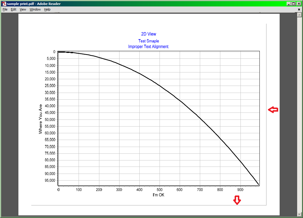

Looks like the latest version (2014.0.0.2) fixed most of the problems. However, there is still one issue on print out - one line on each left and bottom. The attached sample project shows that. To build the project, the files in Tee_Files_0 and TeeFiles_1 need to put in the project's Tee_Files folder which is empty in the MFCApplication1.zip file.
The result will be followed due to the limitation to the files attached.
The print out issue: extra lines on right and bottom.
- smaple print.png (49.3 KiB) Viewed 33619 times
You can set the Outer Bevel to none as noted here.
In your case, you can do as follows to save the status of the Outer Bevel and restore it after printing:
void CMFCApplication1View::OnFilePrint()
if (m_pChart.GetPrinter().ShowSetupDlg()) {
int tmp = m_pChart.GetPanel().GetBevelOuter();
m_pChart.GetPanel().SetBevelOuter(0);
m_pChart.GetPrinter().PrintChart();
m_pChart.GetPanel().SetBevelOuter(tmp);
