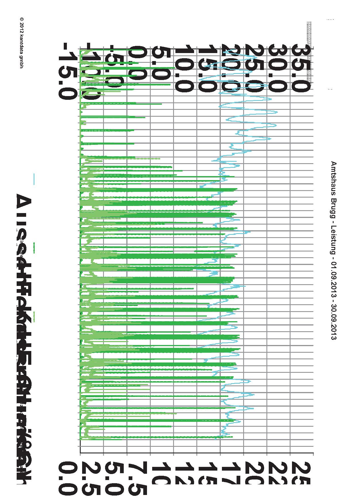

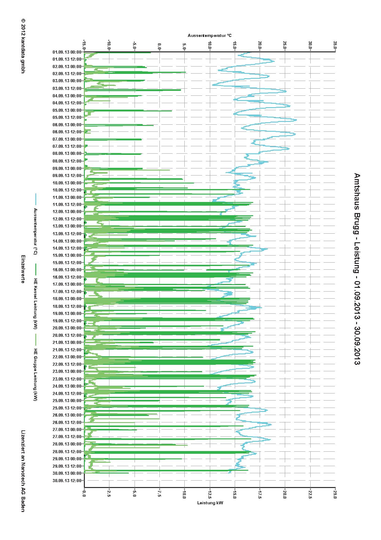

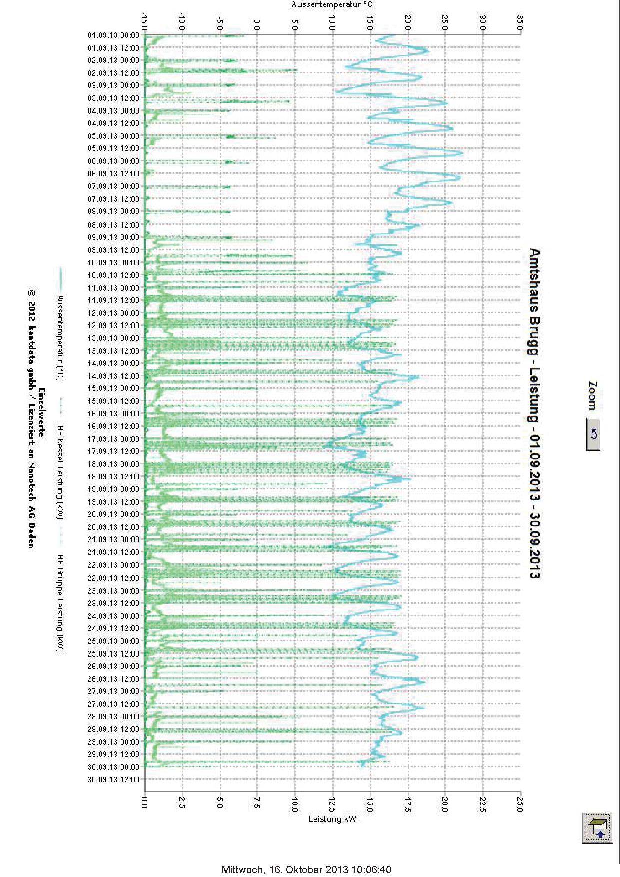

- Screen 2013
- Screen_2013ocx.jpg (349.23 KiB) Viewed 39143 times
- Print 2013
- Print_2013ocx.jpg (368.9 KiB) Viewed 39086 times
- Print 2012
- Print_2012ocx.jpg (340.3 KiB) Viewed 39091 times
Re: Labels and Titles way too large when printing
I'm trying to reproduce the problem here but I can't. Can you please arrange a simple example project we can run as-is to reproduce the problem here?

Hi Andreas,
Thanks for the example. I can not run it due to missing Codejock.Controls.v15.0.2.ocx. However, the issue most likely is the same as discussed here: http://bugs.teechart.net/show_bug.cgi?id=69. This will be included in the following TeeChart Pro ActiveX maintenance release.

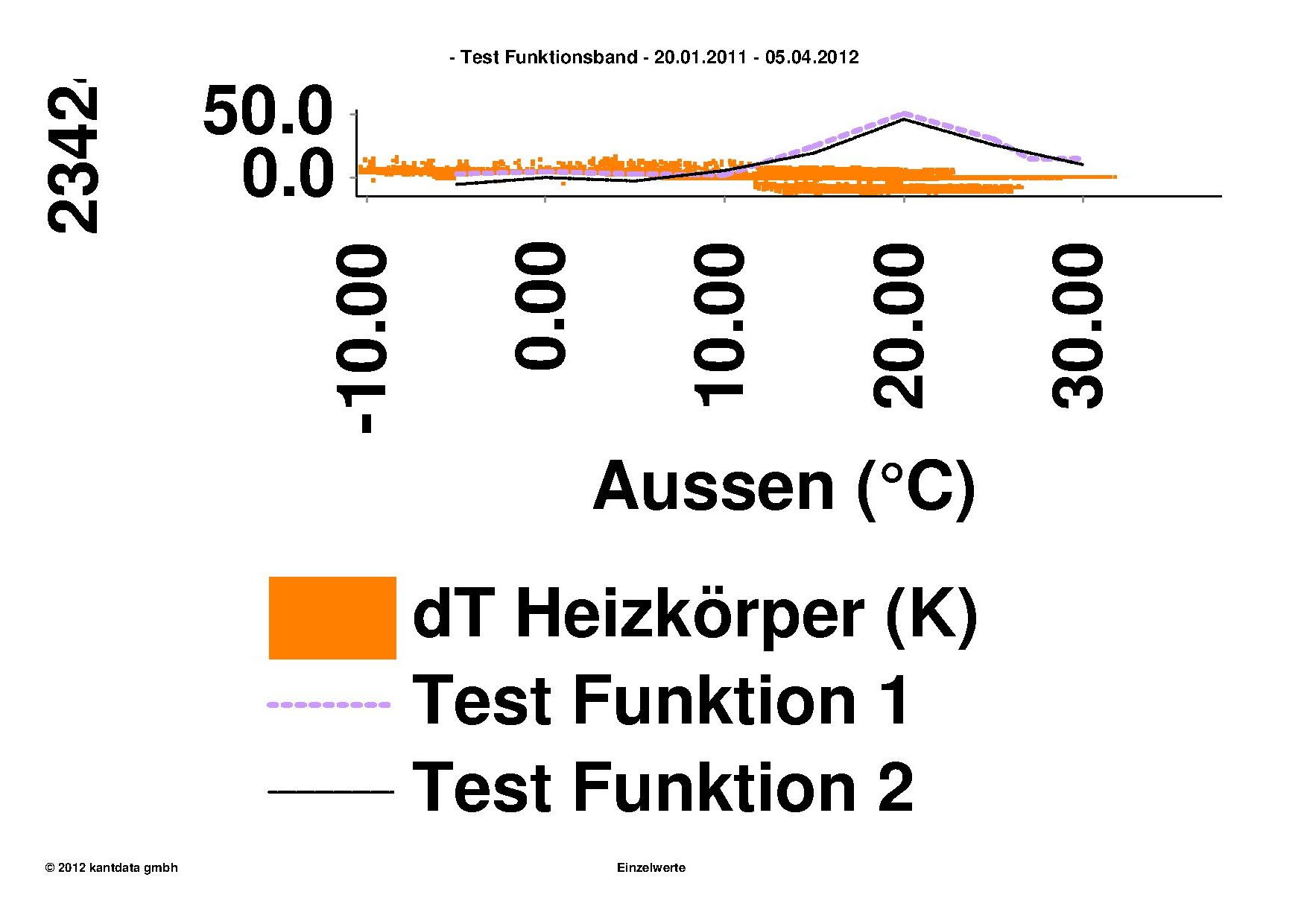

- TeeChart2014_Print.jpg (222.24 KiB) Viewed 38922 times
- TeeChart2014_Screen.jpg (165.02 KiB) Viewed 38938 times
Hi Andreas,
Could you please attach the new example project?
Hi Narcís
I used my production tool to produce the images.
So here's my Test.mdb modified to work with your Test.ocx.
The symptoms are the same.
Best wishes,
Andreas
Best wishes,
Andreas
- Test_TeeChart3.rar
- (94.86 KiB) Downloaded 1876 times
- Site Admin
- Posts: 14730
- Contact:
Hi Andreas,
We are investigating the issue here. In the meantime, a workaround is disabling GDI+ in your chart:
TChart1.Aspect.GDIPlus.Active = False
