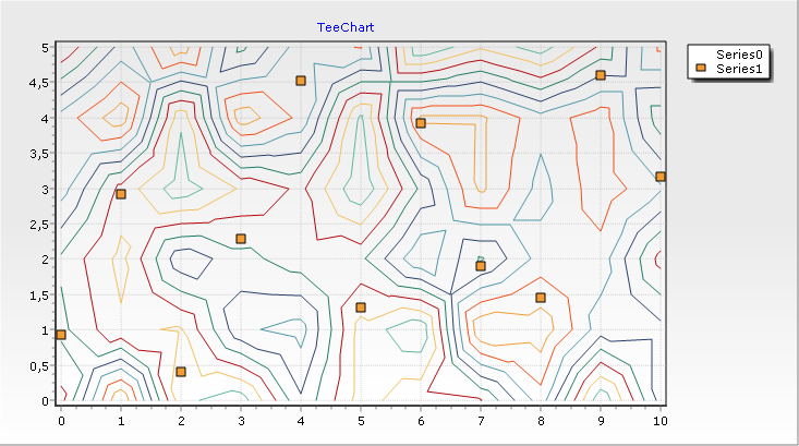

Once you have a Contour series populated (as Narcís explained above) you can add an extra Point series to draw the points you wish.
Here it is an example:
TChart1.Aspect.View3D = False
Dim x, z As Integer
TChart1.AddSeries scContour
With TChart1.Series(0).asContour
For x = 0 To 10
For z = 0 To 5
.AddXYZ x, Rnd * 10, z, "", clTeeColor
Next z
Next x
.IrregularGrid = True
End With
TChart1.AddSeries scPoint
For x = 0 To 10
TChart1.Series(1).AddXY x, Rnd * 5, "", clTeeColor
Next x

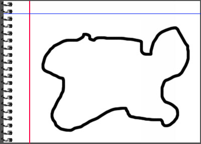

Re: How Contour serie is used???
hi narcis,
I've already check those tutorials and that isn't exactly what I'm looking for.
maybe if you could help me with this, for example how can I draw an irregular shape like the one that is attached, wich series could be used for doing something like that.
David
David
- Irregular.jpg (15.52 KiB) Viewed 37920 times
Hi David,
What about a MapSeries?
Take a look at the exmaple included in the demo at "All Features\Welcome !\Chart styles\Extended\Map GIS"
And here you'll find a simple example of how to draw a triangle:
http://www.teechart.net/support/viewtop ... =3&t=14336
