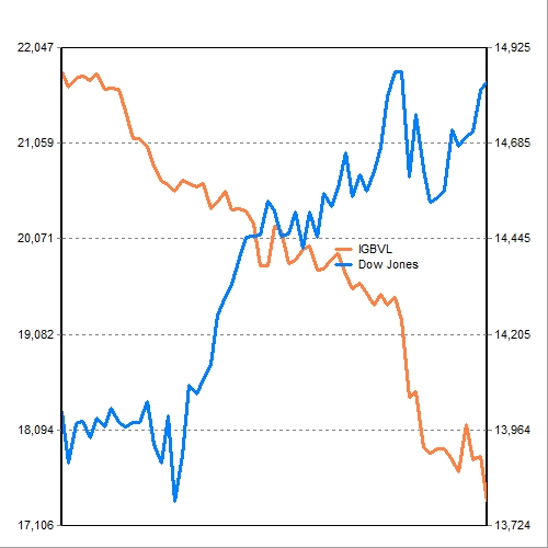

I wanna create a graph with the left axis in Orange color, but the graph is generated with the left axis in black color.
This is part of my code
w_AxeYvalue = wMinimunY1
With Grafico.TChart1.Axis.Left.Labels
.Clear
.Font.Color = RGB(255, 128, 64)
For i = 1 To 6
.Add w_AxeYvalue, Format$(w_AxeYvalue, "###,##0")
w_AxeYvalue = w_AxeYvalue + wStepY1
Next i
End With
What is missing?

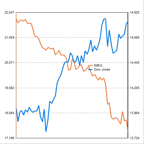

Yes, I wrote this in my code
Grafico.TChart1.Axis.Left.Labels.Font.Color = RGB(255, 128, 64)
But the axis label is print in black Color (like the attach image)
What is missing?
Best regards

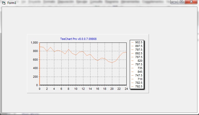

With the Narcís's suggest
TChart1.Axis.Left.AxisPen.Color = RGB(255, 128, 64)
Only the Axis lines is changed, but not the text label
I'm ussing VB6, and Windows 7
Regards

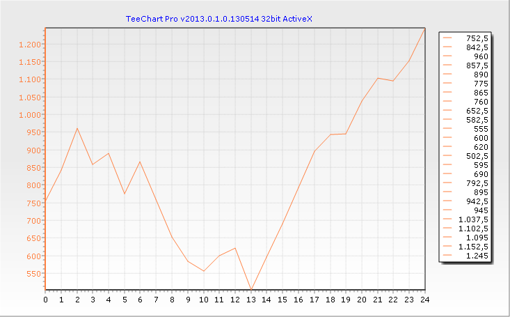

What exact TeeChart version are you using?
It works fine for me here with v2013.0.1.0 and also with v2012.0.0.9:
Private Sub Form_Load()
TChart1.Header.Text.Text = TChart1.Version
TChart1.Aspect.View3D = False
TChart1.AddSeries scLine
TChart1.Series(0).Color = RGB(255, 128, 64)

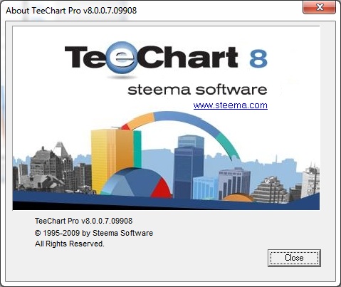

Hi Yeray
This is my version
TeeChart Pro v8.0.0.7.09908
Best regards
This is my version
Best regards

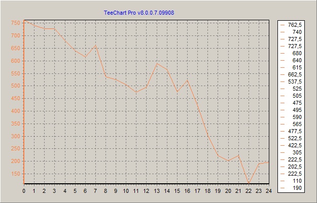

Hi Yeray
Please try this
The left labels titles are in black color, only the left's axis line is orange, and I need the titles in orange
Thanks a lot
Please try this
Thanks a lot
