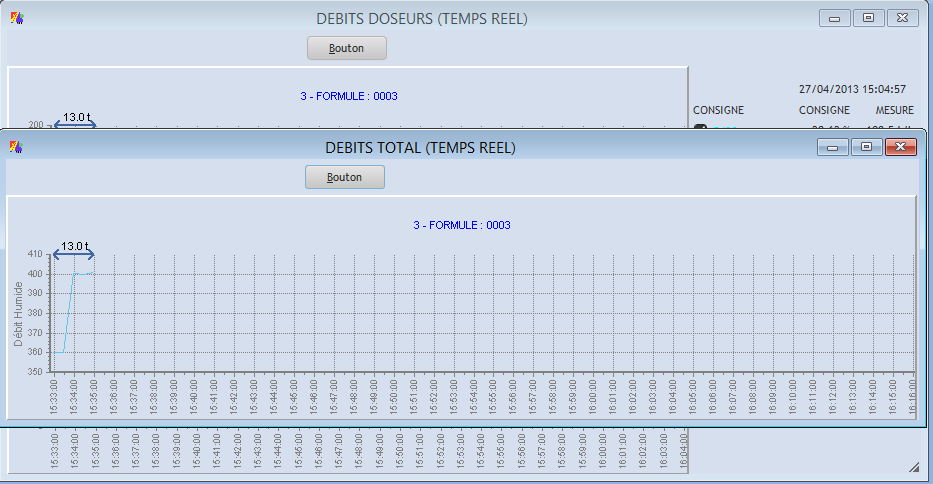

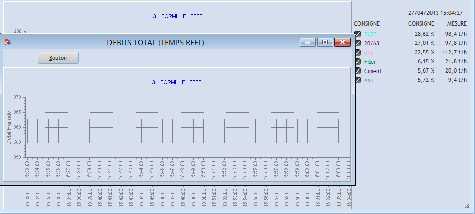

before increasing the size of the window the two scales are correct
after having increased the size of the window the scales are not identical
do you have a solution to keep 10 pixels for 30 seconds
the scale of x-axis change after increase the size of window
- AFTER INCREASE SIZE OF WINDOWS.PNG (22.75 KiB) Viewed 21013 times
- BEFORE INCREASE SIZE OF WINDOWS.PNG (24.44 KiB) Viewed 21006 times

the scale is wrong after restoring then window and after a resize.
take a look on the attachment there is a small difference.
5 PIXELS ENV.
THE SIZE OF X-AXIS IS 625 PIXELS
