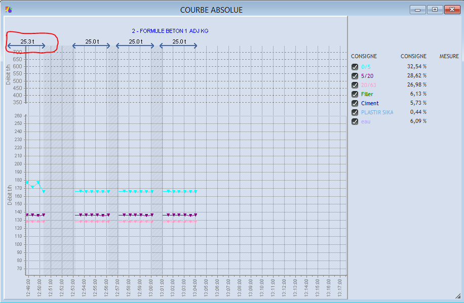

after Scoll, the line drawn on top of the chart is outside the boundaries of the chart

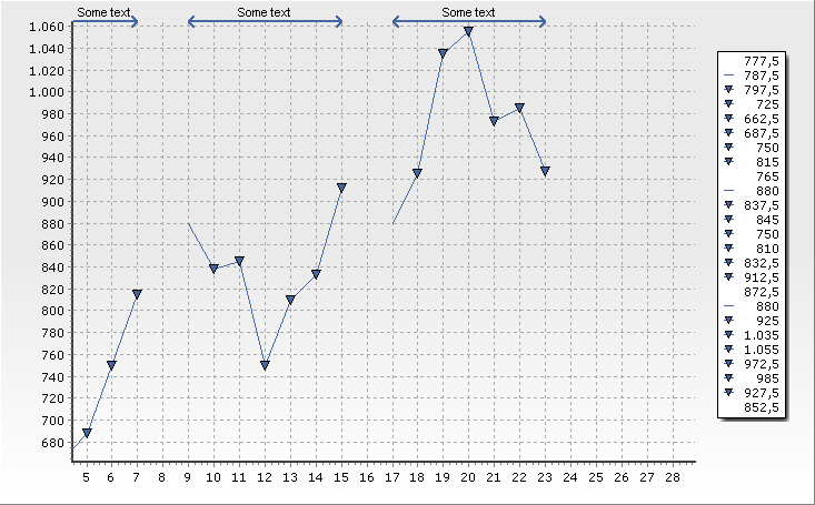

I assume you followed the example I wrote here.
That was just an example to show you how to start. There are basically used:
- FirstValueIndex and LastValueIndex properties to loop through the series.
- IsNull function to check what points are the nulls. In that example the nulls are the frontier between two arrows. Your case may be different.
- CalcXPos to get the X position in pixels of a point.
- GetChartRect Left and Right properties to get the limits of the chart in pixels.
- Canvas DrawLine to draw the different parts of the arrows.
- Canvas TextOut to draw the texts.
The rest is just logic to determine when to draw what part of the arrows. If you find something isn't being drawn as you expected please, feel free to modify that code to fit your needs.

Your example is very clear.
I used to make my program.
everything works fine,
thank you
there is one little problem that I have not solve.
when I scroll the chart, the lines drawn outside the chart.
for marks
Marks.clip = true
for points
tchart1.clip = true

Right. These clip functions control whether a mark or a point has to be drawn out of the boundaries or not.
However, since these arrows are being drawn manually at OnAfterDraw event, you have to fully control it in the same event.
On the other hand, when I scroll that example, the arrow looks fine for me here: I'm using TeeChart v2012.0.0.9, VB6 and Windows 7 x64
Also note you can also set a region clipping before using the drawing functions at OnafterDraw event, and unclip the region after the drawing. For example:
With TChart1.GetChartRect
TChart1.Canvas.ClipRectangle .Left, 0, .Right, .Bottom
End With
'Drawing stuff
TChart1.Canvas.UnClipRectangle
