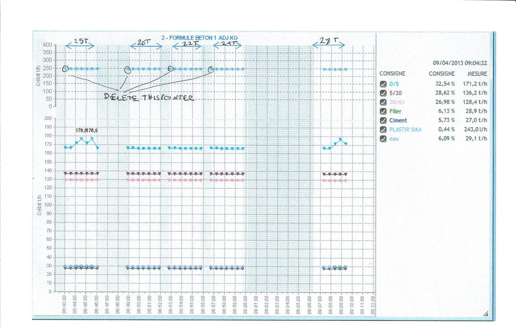

is it possible to draw arrows with text at the top of the chart (see attachment)
the arrows en text must scroll horizontaly with chart
arrows should not scroll vertically if the chart scroll verticallypoints in the chart are drawn in real time, a point every 30 seconds
Is it possible to delete the first "POINTER" each part of "scline" (see attachment °
thks

Let me start from the second part:
jika wrote:Is it possible to delete the first "POINTER" each part of "scline" (see attachment °
This can be achieved using the OnGetPointerStyle. Of course you have to know the index of both the SeriesIndex and the ValueIndex to hide, or how to calculate them:

jika wrote:is it possible to draw arrows with text at the top of the chart (see attachment)
This is a bit more tricky. I'd draw both the arrows and the texts manually. Here it is an example:
