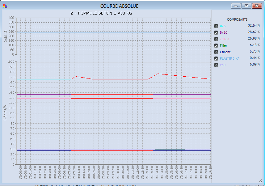

look at the first attachment,
I have 7 scline in a chart with multiple axes on the Y axis
Scline one is attached to the first custom axis (0.04 to 0.4)
the other 6 are attached to the second custom axis (0 to 200)

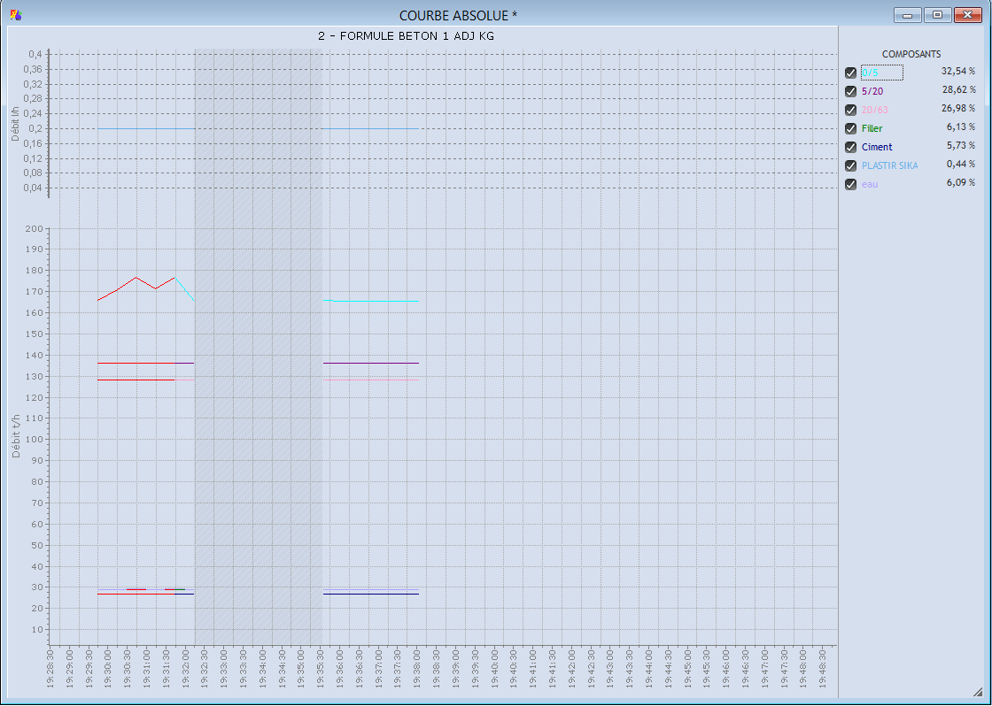

when I scroll up the second chart (0-200), the scline reach the first chart (see the second attachment)
the scline should not exceed the limits of their axis, they must disappear.
Note: this chart has 2 axis customs. On axis Y.
Has No custom chart this axis is absice.
How to scline that remain within the limits of their axes.

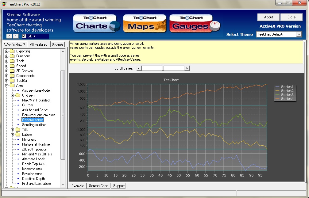

It looks as what is shown in the "Opaque Zones" example in the features demo.
Find in at "All Features\Welcome !\Axes\Opaque zones".

Re: scroll in chart scline, with multiple axes
Post by Sandra » Wed Mar 27, 2013 3:24 pm
Hello jika
You must open the project TeeChart Activex Pro V2012 you will find as shortcut in the Program Group of start menu or in a similar path as next C:\Program Files\Steema Software\TeeChart Pro v2012 ActiveX Control\Examples\Visual Basic\TeeChartAXV2012Demo and run the TeeChartAxV2012.exe. After you execute the demo please go to tab All Features \ Welcome! \ Axes \ Opaque areas. See next image to understand good my indications:

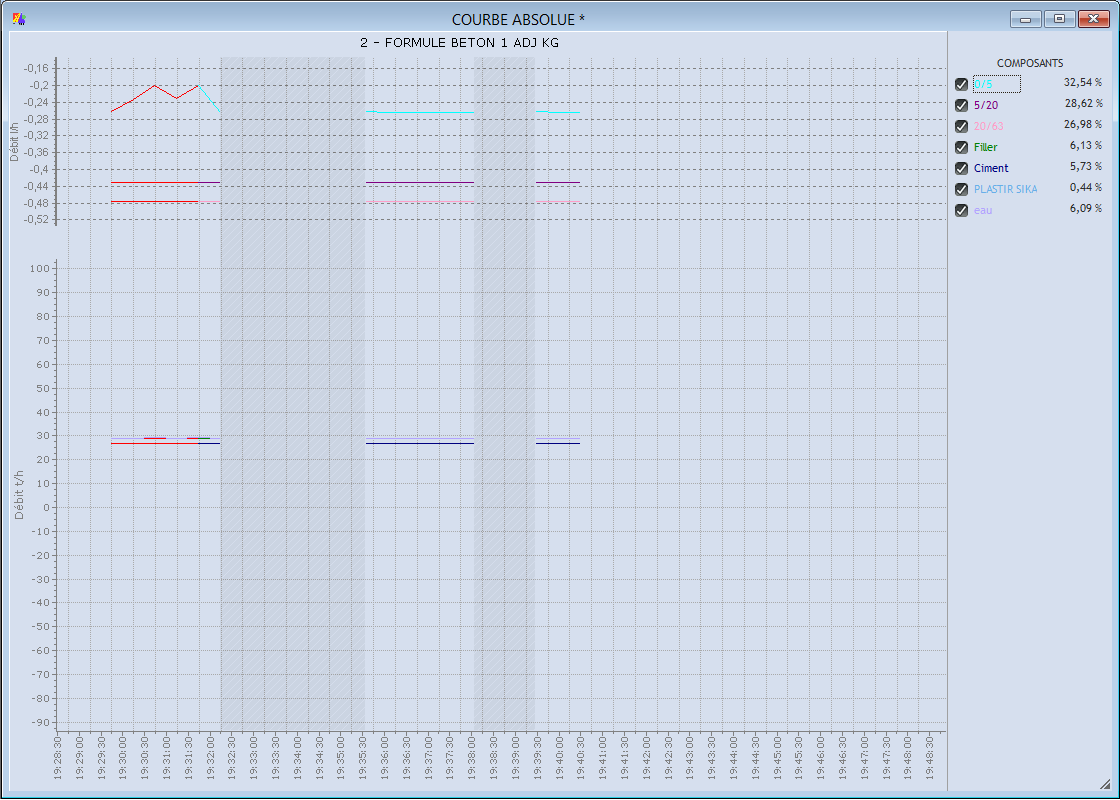

but is it possible to scroll in one or other of the chart. I do not want to scroll all the chart at the same time
i have a chart with one main axis
and one custom axis
thank you

To scroll/zoom each zone individually you should disable the default scroll/zoom feature and implement your version of it.
For example, this seems to work in the opaque zones example mentioned above:
Dim MouseDownX, MouseDownY, custAxisIndex As Integer
Dim inLeft As Boolean
Private Sub Form_Load()
  With TChart1
    .Zoom.Enable = False
    .Scroll.Enable = pmNone
    MouseDownX = -1
    MouseDownY = -1
    custAxisIndex = -1
    inLeft = False
  End With
Private Sub TChart1_OnMouseDown(ByVal Button As TeeChart.EMouseButton, ByVal Shift As TeeChart.EShiftState, ByVal X As Long, ByVal Y As Long)
  If Button = mbRight And _
     X > TChart1.Axis.Bottom.IStartPos And X < TChart1.Axis.Bottom.IEndPos And _
     Y > TChart1.GetChartRect.Top And Y < TChart1.GetChartRect.Bottom Then
    Dim i As Integer
    For i = 0 To TChart1.Axis.CustomCount - 1
      If Y > TChart1.Axis.Custom(i).IStartPos And Y < TChart1.Axis.Custom(i).IEndPos Then
        custAxisIndex = i
        Exit For
      End If
    Next i
    If custAxisIndex = -1 And _
       Y > TChart1.Axis.Left.IStartPos And Y < TChart1.Axis.Left.IEndPos Then
      inLeft = True
    End If
    MouseDownX = X
    MouseDownY = Y
  End If
Private Sub TChart1_OnMouseMove(ByVal Shift As TeeChart.EShiftState, ByVal X As Long, ByVal Y As Long)
  If MouseDownX <> -1 And MouseDownY <> -1 Then
    If custAxisIndex > -1 Then
      With TChart1.Axis.Custom(custAxisIndex)
        tmpIncr = .CalcPosPoint(MouseDownY - Y) - .CalcPosPoint(0)
        .SetMinMax .Minimum + tmpIncr, .Maximum + tmpIncr
        MouseDownY = Y
      End With
    Else
      If inLeft Then
        With TChart1.Axis.Left
          MouseDownY = Y
        End With
      End If
    End If
    With TChart1.Axis.Bottom
      tmpIncr = .CalcPosPoint(MouseDownX - X) - .CalcPosPoint(0)
      MouseDownX = X
    End With
  End If
Private Sub TChart1_OnMouseUp(ByVal Button As TeeChart.EMouseButton, ByVal Shift As TeeChart.EShiftState, ByVal X As Long, ByVal Y As Long)
  MouseDownX = -1
  MouseDownY = -1
  custAxisIndex = -1
  inLeft = False
