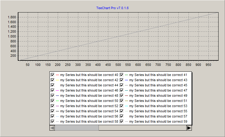

The project you have attached give me problems when trying to execute it.
However, I've translated the relevant code from it to VB6 and it seems to work fine for me here:
This is what I get when I run the VB6 application above with TeeChart 7.0.1.6:
That looks correct to me. Isn't it?
However, if I use the legend scrollbar, I get the following error:
I can't reproduce the error with the actual TeeChart version. Have you tried it?
TChart1.RemoveAllSeries
TChart1.Aspect.View3D = False
Dim seriesctr, datactr As Integer
For seriesctr = 0 To 60 - 1
TChart1.AddSeries scLine
For datactr = 2 To 1000 - 1
TChart1.Series(seriesctr).AddXY datactr, datactr + datactr, "", clTeeColor
Next datactr
TChart1.Series(seriesctr).Title = "my Series but this should be correct" + Str$(seriesctr)
TChart1.Series(seriesctr).Active = True
Next seriesctr
TChart1.Tools.Add tcLegendScrollBar
TChart1.Legend.Alignment = laBottom
TChart1.Legend.Symbol.Width = 5
TChart1.Legend.CheckBoxes = True
Is this the error you are also finding?Access violation at address 06754838 in module 'TeeChart7.ocx'. Read of address 00000030.
