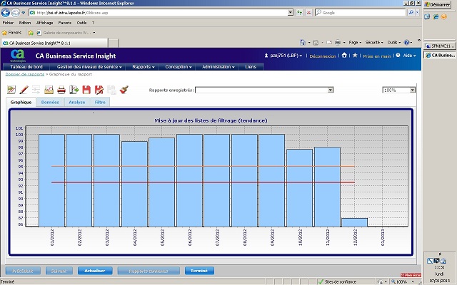

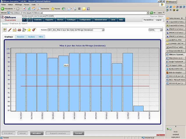

Post by Chen Yang » Fri Jan 11, 2013 6:33 am
Teechart V7
Teechart V2010

Post by Chen Yang » Thu Jan 17, 2013 11:23 am
Hi Sandra,
the attached is our codes.
if use your demo codes, work fine.
now I describe the difference.
1. my codes is for JScript. I hope you can send my demo codes for JSCript. thanks
2. I have uploaded two images. we need not to display all bubbles. If move mouse pointer to one column, TChart will display value of the column.
I have uploaded my codes, please see the attached. Can you help me to analyze my codes? thank you so much.
