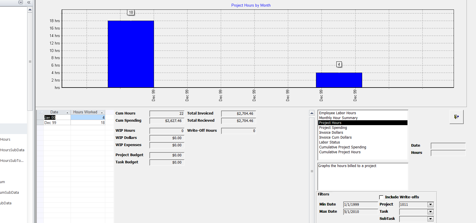

Why is this happening? It's like the bottom axis is offset. Am I missing something?
Also, I would like to have each bar shown at the beginning of each month's tick and only one tick per month. How do I accomplish this?

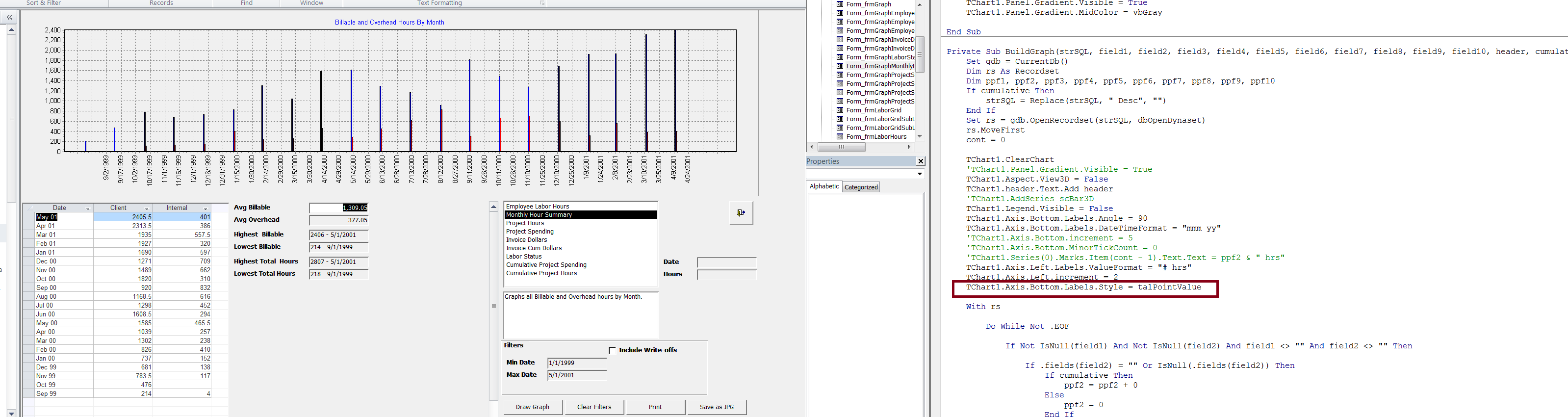

Post by n84_All » Wed Jan 09, 2013 9:01 pm
Figured it out myself. By the way all that you said had nothing to do with it.

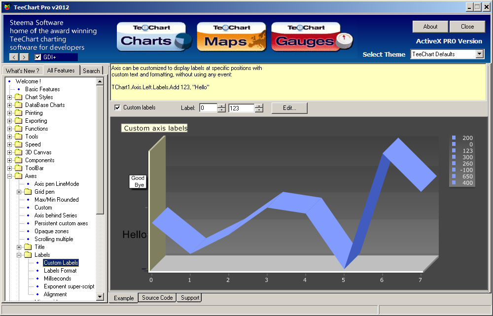

n84_All wrote:'at "All Features\Welcome !\Axes\Labels\Custom Labels"' ???
Yes. See the image:
Custom Labels.png (71.86 KiB) Viewed 15606 times
n84_All wrote:I'm interested in trying the implementation of the custom label solution. I need a little more information on how the custom label API looks like tho. Thanks.
As you'll see in the Custom Labels example above, you basically have to call the Clear function, and then add the labels you like giving the value and string to be shown.
  TChart1.Axis.Bottom.Labels.Clear
  TChart1.Axis.Bottom.Labels.Add myValue, myString
