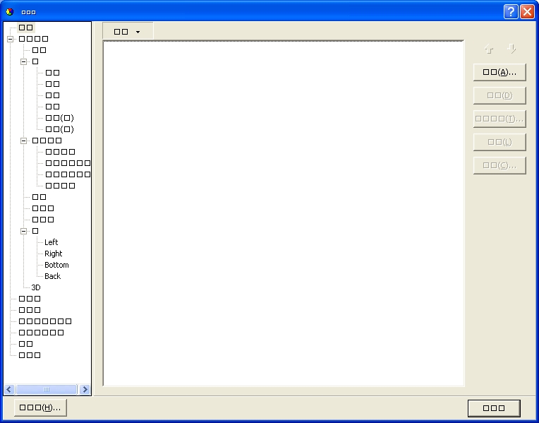

Just installed version teechart2012.0.0.8 and i'm still having issues with the fonts in the editor of the component.
It seems that version 2012.0.0.8 on my system !
System Window XP SP3 french MUI, component use with VB6 SP6
Claude Simard
Claude Simard
- Bad editor fonts
- Font_editor.jpg (206.58 KiB) Viewed 13628 times

Hi Claude,
Are you using any special setting (ie modified font)?
I can see the texts correctly in French, in a Spanish Win7 x64 machine here.

Previous version ActiveX 8.0.1.0.101222 working fine, still active on my machine.
No special setting or modified fonts use.
See editor windows picture for my v2012.0.0.8. I try to uninstall and reinstall the product with same result. Any idea what could be wrong ?

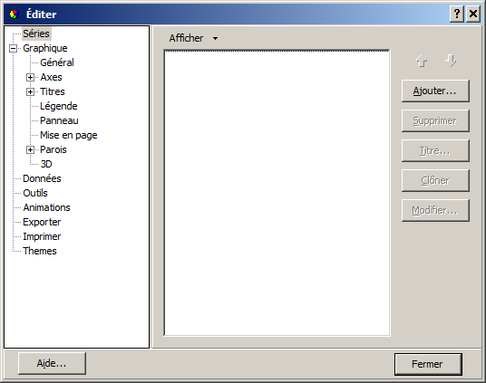

That's strange. This is how it looks in a Win7 x64 here: We'll continue trying to reproduce this here.

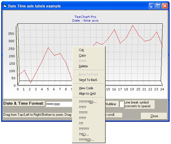

Then, please try to change the language to English first by:
- Select the Language option in the contextual menu, at design time. This is the second option counting from the bottom as you can see here:
It should be the "??(L)" option for you:

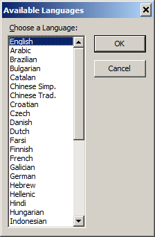

- Then, in the next screen, you should see a combobox, where the first option is "English". Select it and click "OK" (the button on the top): - Close and restart the IDE to apply the changes on the contextual menu.

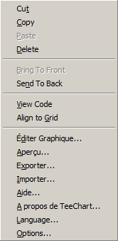

Thanks Yeray for your support, Japaneese fonts was selected (don't know why) .
Using English language and back to French and menu are OK .
