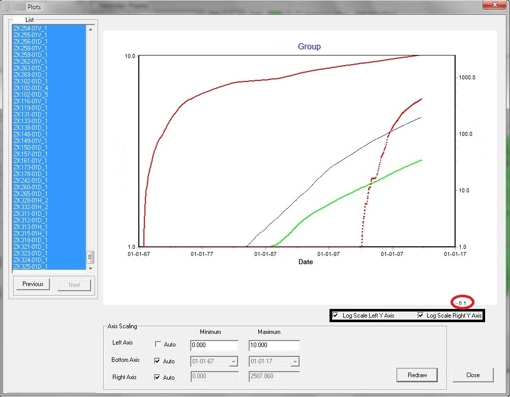

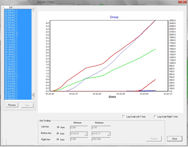

There are few issues we are coming across w.r.t. log scale when applied on any plot. Following is the scenario on which the issue arises.
1. Normal Plot without apply Log scale (Working fine)
1st poic

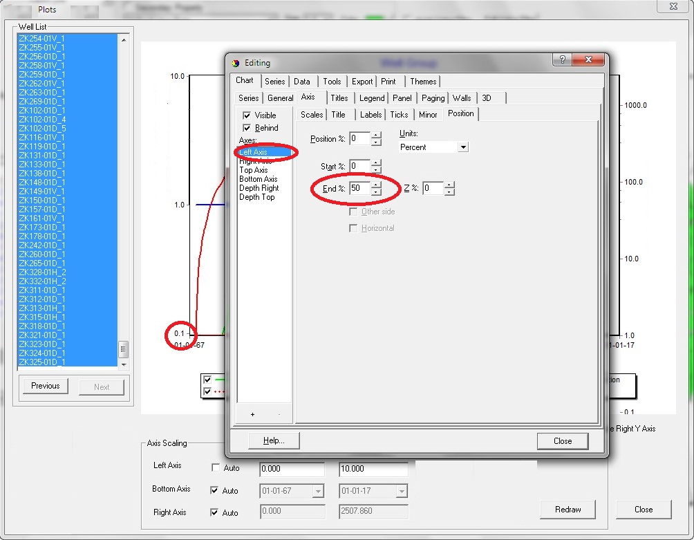

2. When we check “Log Scale Left Y Axis” and “Log Scale Right Y Axis”, both the axis i.e. left and right are shifted below the end of the chart as shown below.
second pic
3. When we adjust left axis position by adjusting End% as shown through the settings below, it looks like as shown in figure below.

Post by Yeray » Mon Jun 25, 2012 3:13 pm
Hi Amol,
I think I understand what's happening. It seems that the labels are not clipped to the according axis size when it's a logarithmic axis, so extra labels are drawn out of the ChartRect if there's enough margin. I've added it to the list (TV52016231).
