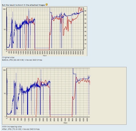

Hi Yeray, thanks for replying.
I am doing exactly that:
But the result is shown in the attached images
I tried to put but I get an error. I don't know if that is the solution but I don't find what is the appropriate sentence.
Thank you very much.
Best regards,
JAV

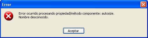

Hi Yeray:
Can you tell me please where is de property: Auto size, or how to maximize the ocx?
When I put:
or
It returns the attached error:
Thank you very much
When I put:
Chart1.AutoSize = TRUE
Chart1.MAXIMIZE = TRUE
Re: Resize chart
Hi JAV,
There's no AutoSize property for the TeeChart.TChart object. There is an AutoSize property for Annotation tool, TextShape,... and similar objects, but not for the chart itself.
It has to be something particular in your IDE. Maybe is IDE who embeds the COM components into something that is causing all this: some extra properties, what looks as a frame that isn't resized with the component inside it,... just an hypothesis.

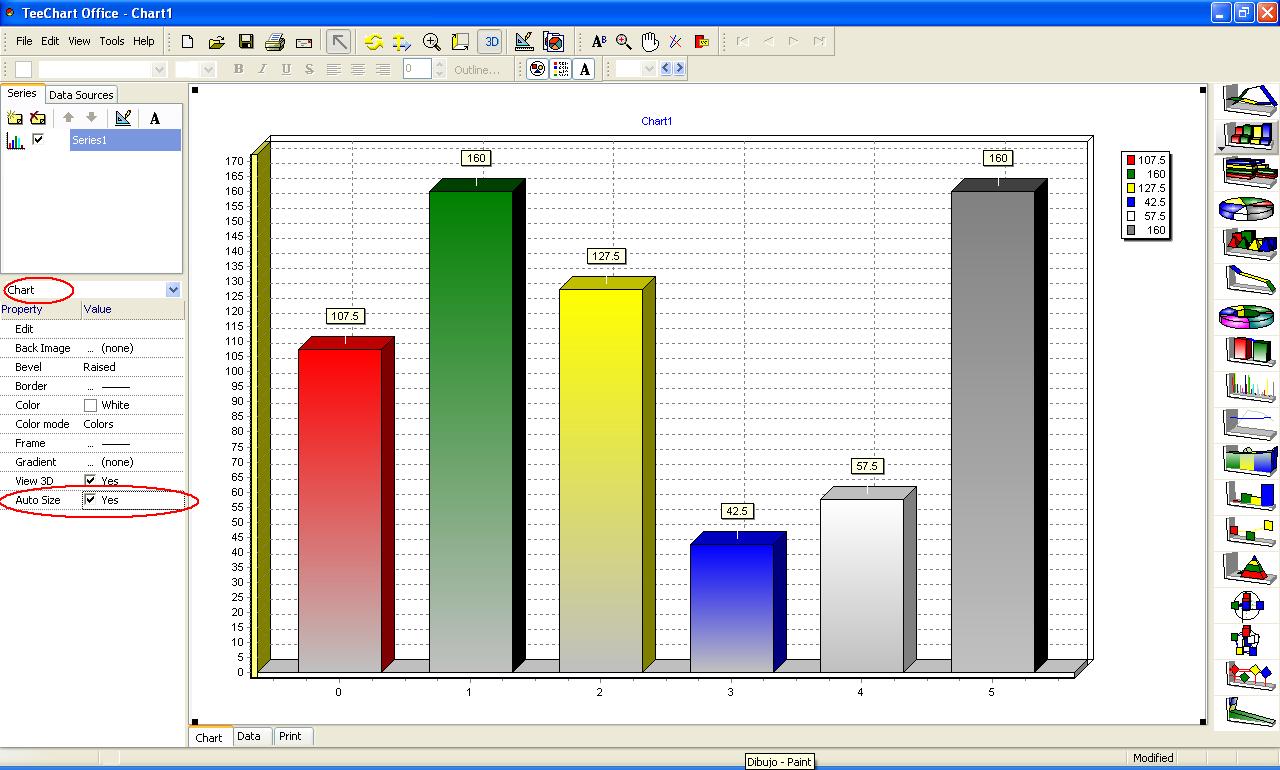

Re: Resize chart
Hola Yeray,

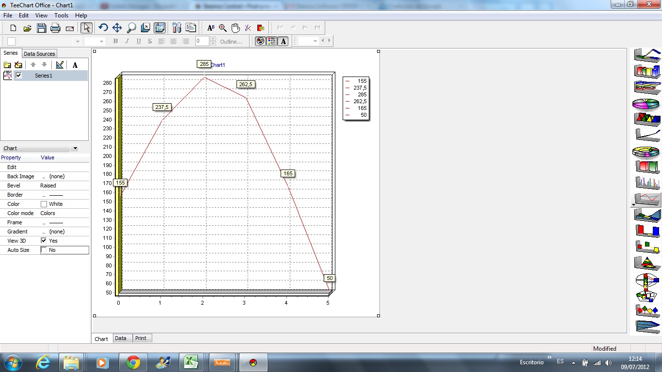

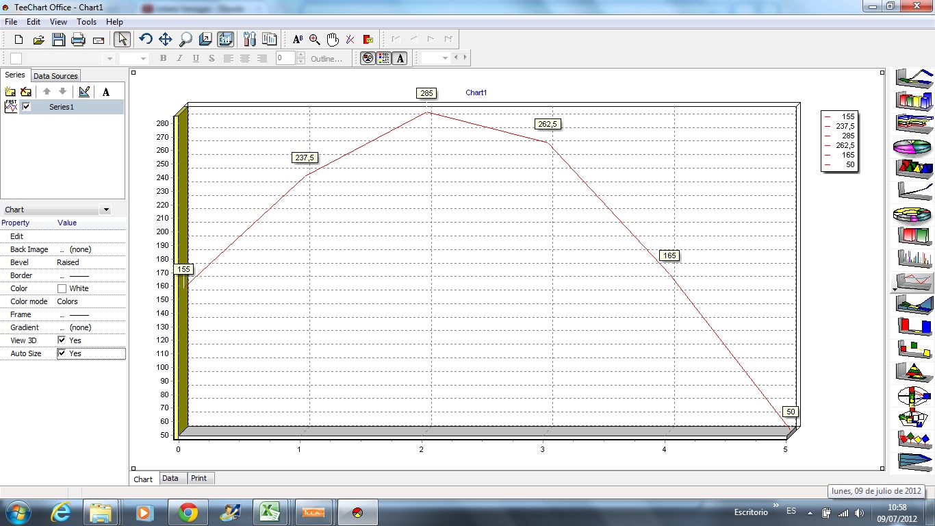

Right now I am working directly on TeeChart Office just to understand how this functionality really works before implement it. There is an attribute or property named Auto Size (please see attached images). This "auto size" option allows to do exactly what I need:
When it is inactive the chart is in its original size even though the frame or window is maximized , when it is active the chart fit the window size. What is the appropriated command line to do this?
Thank you very much, regards

Re: Resize chart
Hi JAV,
TeeChart Office is developed with TeeChart VCL, not with TeeChart ActiveX.
In VB6 you can use the Align property as mentioned above.
However, I'm not sure in your IDE. And there isn't, either in VB6, a property to align the control to the four sides, like in delphi alClient.
To do the same in TeeChart ActiveX, you still could use a resize event to assign the new chart dimensions.

Auto Size property
What are the specific command line to do what is showed in the pictures attached?
We want that our chart adjusts to the window automatically. So we need to program the "yes" check in the option Auto Size.
Thank you very much, regards,
JAV

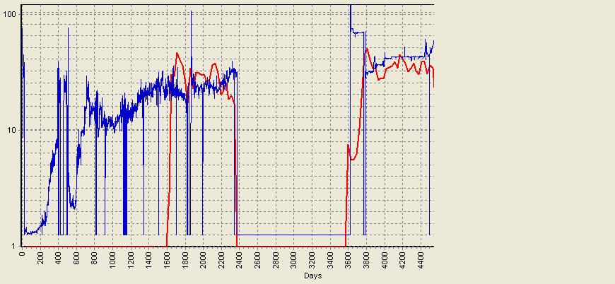

ok you caught us!
Effectively it is the same discussion! And it is because we still haven't solved the problem: Our IDE works the same as VB6, we have maximized the frame and with resize event we've maximized the activeX, it means, we adjusted the ActiveX to our frame, but the image looks truncated, as we showed in the previous post.
Please, tell us something different, we've already tried every instruction you gave before.
ok you caught us!
