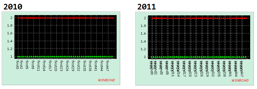

Hello.
We upgrade tee chart from TeeChart2010.0.0.3ActiveX to TeeChart2011.0.0.4ActiveX.
Please take a look at the following pictures.
The x axis lables are in a mess.
2010.png : TeeChart2010.0.0.3ActiveX
2011.png : TeeChart2011.0.0.4ActiveX
Can you tell me how to fix this ?

We've tried v2011.0.0.5.
It seems nothing change to me.
The X axis label are still in a mess.
Any idea ???

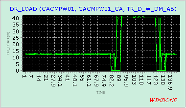

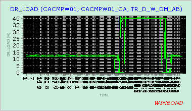

Line chart is ok with
tChart.Axis.Bottom.Labels.Style = EAxisLabelStyle.talValue;
As for point chart. Value is no meaning for us. We would like to show text in X axis label.
2010 version is no problem.
2011 version is not good for me.
any idea ?

With v2011.0.0.4 or v2011.0.0.5, the only solutions I see:
- Only add one series with labels. In your example, if I change the second series loop for this, it seems to work fine:
            for (int i = 0; i < 50; i++)
                iSeries.AddXY(i + 0.5, 2, /*"second" + i*/ "", 0x0000ff);
- Use custom labels instead of letting talText to draw all the labels of all the series. Adding this at the end of your Main method (just before exporting the chart to png) it seems to work fine:
            tChart.Environment.InternalRepaint();
            int lastpos = 0;
            tChart.Axis.Bottom.Labels.Clear();
            for (int i = 0; i < tChart.Series(0).Count; i++)
                if ((lastpos == 0) || (tChart.Axis.Bottom.CalcXPosValue(tChart.Series(0).XValues.Value[i]) - lastpos > 10))
                    tChart.Axis.Bottom.Labels.Add(tChart.Series(0).XValues.Value[i], tChart.Series(0).PointLabel[i]);
                    lastpos = tChart.Axis.Bottom.CalcXPosValue(tChart.Series(0).XValues.Value[i]);
