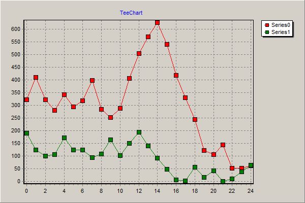

I have a problem using GetExport().SaveToJPEGFile() of TeeChart.
I'm using TeeChart ver 7.0.1.5.
There are two captures were made GetExport().SaveToJPEGFile() method.
They were using same program.
Look at this picture. It is normal.
Another Picture.
It is error image.
An Additional explanation,
[normal case]
: can be seen on the screen and be used GetExport().SaveToJPEGFile()
[error case]
: can't be seen on the screen and be used GetExport().SaveToJPEGFile()
I'll be waiting for your answer.

Hi Seth,
Maybe you are just calling the SaveToJPEGFile function with inappropriate arguments. The following example made with VB6 and TeeCahrt v7 seems to work fine:
Private Sub Form_Load()
  TChart1.Aspect.View3D = False
  Dim i As Integer
  For i = 0 To 1
    TChart1.AddSeries scLine
    TChart1.Series(i).asLine.Pointer.Visible = True
    TChart1.Series(i).FillSampleValues 25
  Next i
  TChart1.Export.SaveToJPEGFile "C:\tmp\test.jpg", False, jpegBestQuality, 80, 600, 400
Please, check the differences between how do you produce both images and try to explain them.
