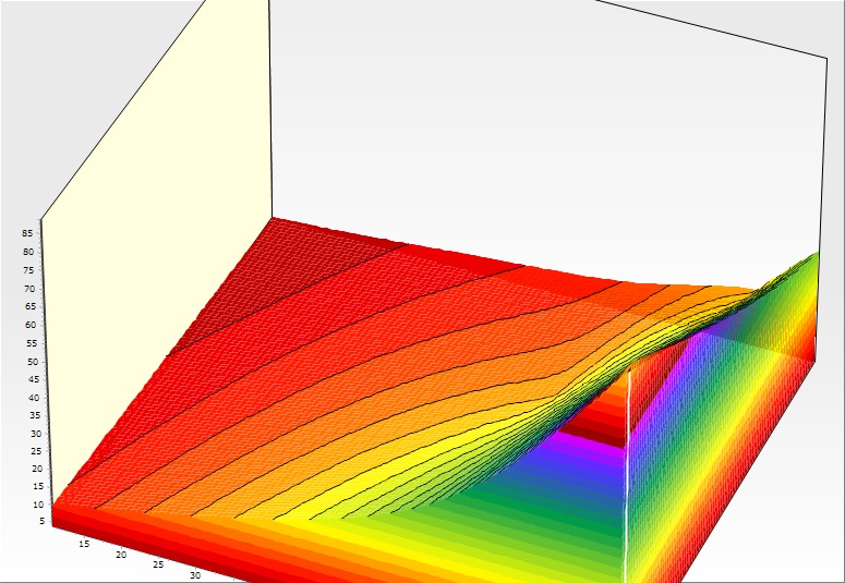

The sidebrush is still not displaying correctly. It is displaying on the back wall where there is no data. See this picture:

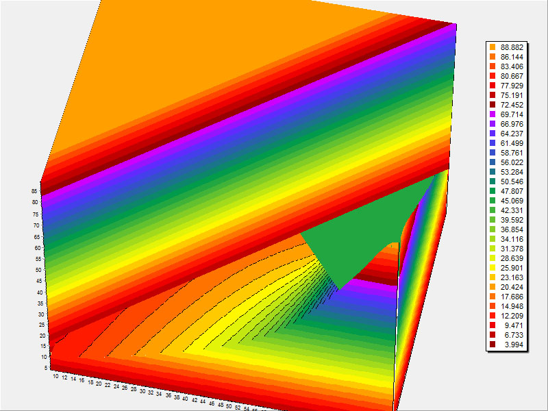

The chart should display like this (net Framework Version)

Post by Narcís » Mon Sep 26, 2011 10:12 am
Hi lilo,
Can you please attach a simple example project we can run "as-is" to reproduce the problem here?
