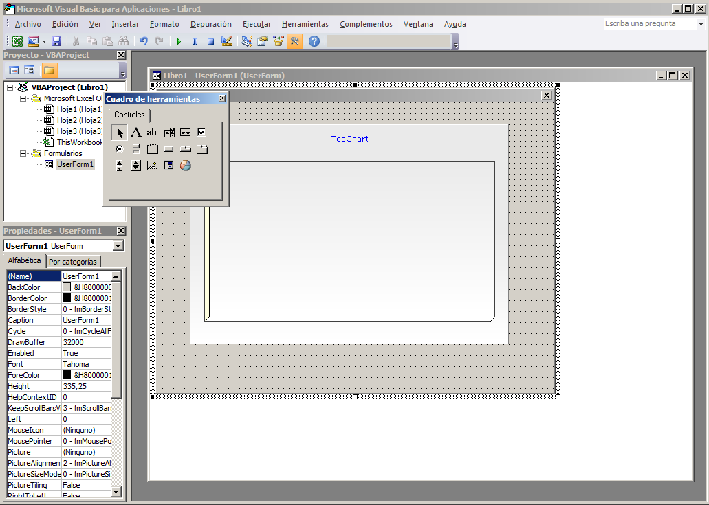

Re: ActiveX 2010 on Excel Form
Post by Yeray » Mon Aug 29, 2011 3:22 pm
Hello Jurgen,
Thanks for the steps. I could add a chart to the UserForm without problems.
Libro1.zip
(11.54 KiB) Downloaded 640 times
I'm on Windows 7 x64, Office Professional 2010 (14.0.5128.5000) (32 bits), TeeChart AX 2010.0.0.3.
