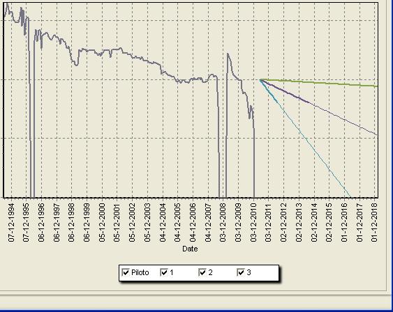

Hello, we just found that grouping series using SeriesGroup could be a way to solve our need, but we have the following issue:
Please refer to Ejecucion1.jpg:
In this graph, the gray series belongs to the group named "PILOTO", the green line to "1", violet line to "2" and blue line to "3", but how can we assign a color to a series group?
and how can we display the color on a legend ?(but one color for each group).

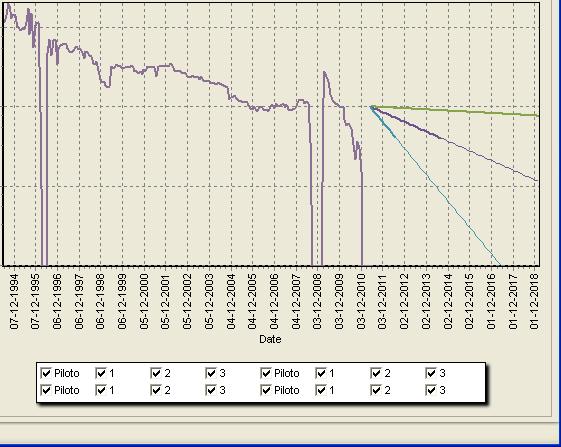

Another issue: Any time that we click on the graphic to regenerate it (in the case we want another random color), the legend doesn't refresh but remains and cumulates with each click. How can the legend be refreshed and cleaned (Ejecucion4.jpg: note how after four clicks we now have the leyend four times).

- Ejecucion4.jpg (Second issue)
- Ejecucion4.JPG (54.55 KiB) Viewed 13894 times
- Ejecucion1.jpg (First issue)
- Ejecucion1.JPG (51.33 KiB) Viewed 13879 times

I'm afraid it's not possible to set a series group legend symbol. Note that a series group can be formed by different series types so TeeChart can't decide what symbol to use.JAV wrote:Hello, we just found that grouping series using SeriesGroup could be a way to solve our need, but we have the following issue:
However, you can always use custom drawing techniques to draw your symbols manually. Something as follows:

I suspect you are recreating the series each time the chart is clicked, without clearing the chart. That's the easier explanation for your "increasing legend" problem. However, I'm not sure if that is really the problem as I haven't seen the project, and I'm not sure either if what you would like to do is to refresh the series data or completely destroy all the series and recreate them.JAV wrote:Another issue: Any time that we click on the graphic to regenerate it (in the case we want another random color), the legend doesn't refresh but remains and cumulates with each click. How can the legend be refreshed and cleaned (Ejecucion4.jpg: note how after four clicks we now have the leyend four times).
If you still have problems with this, please try to arrange a simple example project we can run as-is to reproduce the problem here.

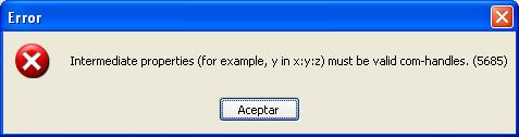

Thanks for replying. I think your suggestion is good, but in the next line I get the error attached in the picture. What am I doing wrong?
Regarding the latter point, indeed, I am recreating the series each time the chart is clicked, i don't know how clear the chart. I'm using:
Something I'm doing wrong
TChart1.Canvas.DrawLine TChart1.Legend.Item(i).SymbolRect.Left, TChart1.Legend.Item(i).SymbolRect.Top + 5, TChart1.Legend.Item(i).SymbolRect.Right, TChart1.Legend.Item(i).SymbolRect.Top + 5
TChart1.RemoveAllSeries
TChart1.SeriesList.ClearValue

I solved the error attached in the previous message by changing the original code:
by:
Perhaps the error occurred because I'm working with version 8 and not the last one.
Please, only I need to know how clear the chart, or how to change the color of the series without regenerate the graph?
Thanks a lot!
JAV
TChart1.Canvas.DrawLine TChart1.Legend.Item(i).Left - 15, TChart1.Legend.Item(i).Top + 5, TChart1.Legend.Item(i).Left - 5, TChart1.Legend.Item(i).Top + 5

Regarding the cleaning problem, I'm not sure to understand why do you need to remove the series. You don't need to remove all the series and recreate them to change their color.
Could you please explain your situation? Or even better, could you please arrange a simple example project we can run as-is to reproduce the situation here?
