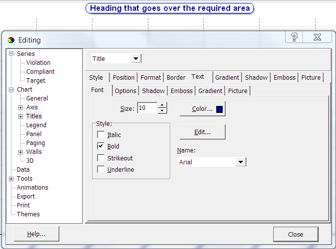

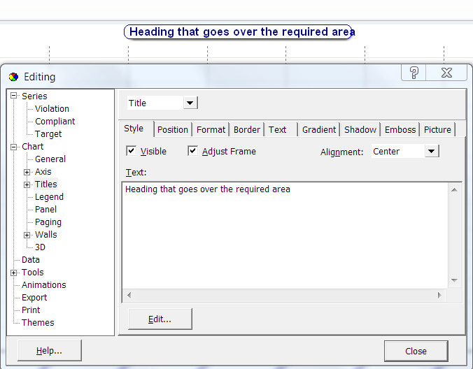

I have a chart, with a predefined heading.
After changing the heading programatically, then the border around the heading is too small for it.
(See header_text1.png).
If I go into the chart properties, and click the "Text" tab (header_text2.png), then the header refreshes itself correctly.

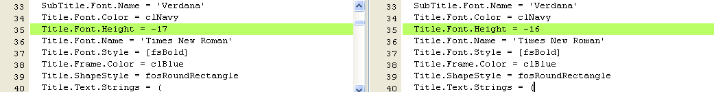

If I compare the two .tee files in text format, then the difference is whether "Title.Font.Height" is -17 or -16. (see header_tee.png)
- header_tee.png (10.09 KiB) Viewed 15932 times
- Header text with correct border
- header_text2.png (41.92 KiB) Viewed 15947 times
- Header text with border too small
- header_text1.png (38.57 KiB) Viewed 15953 times
