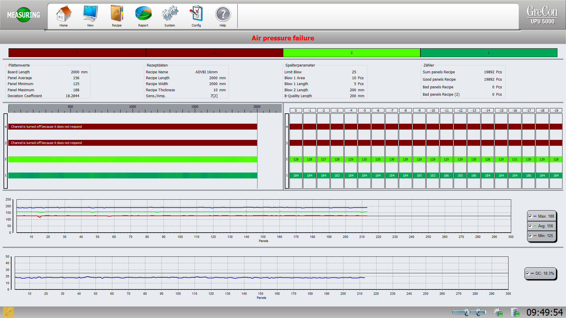

we are using TeeChart Pro ActiveX 8.0 (8.0.1.0) in our native C++ application.
We have 2 teechart components containing fastline series (TeeChart::scFastLine).(See sample picture attached)
We figure out that teechart allocates a lot of memory.

Sample application picture
