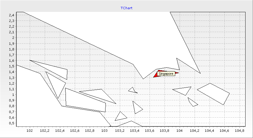

And here it is with the following code in TeeChart:
uses TeeWorldSeries;
var Series1: TWorldSeries;
var i: Integer;
  Chart1.View3D:=false;
  Chart1.Legend.Visible:=false;
  Series1:=Chart1.AddSeries(TWorldSeries) as TWorldSeries;
  Series1.Map := wmWorld;
  Series1[1839].Text:='Singapore';
  Series1[1839].Color:=clRed;
  Series1.Marks.Visible:=true;
  Series1.OnGetMarkText:=Series1GetMarkText;

AccessCoder wrote:Also, it doesn't appear on the Asia map either and that is where it would be the most useful. How do I go about adding a polygon for Singapore?
You're right, it only appears in the World map and should also appear in the Asia map. I've added it to the defect list to be implemented in future releases (TV52015380).
