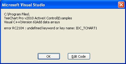

I tried to open the projects under Visual C++\version 6\ with VS2008, and after the conversion to VS2008, the adding data arrays and drag points demo had errors when I tried to open the resource to check the dialog. The error screens are attached. I reinstalled ver2010 again and the problems remained. When I tested the demo under Examples\Visual Studio .NET\Vc++\Dragging Points using VS2008, the same error occured.
- Dragging.JPG (15.42 KiB) Viewed 23829 times
- AddingArray.JPG (15.04 KiB) Viewed 23820 times
